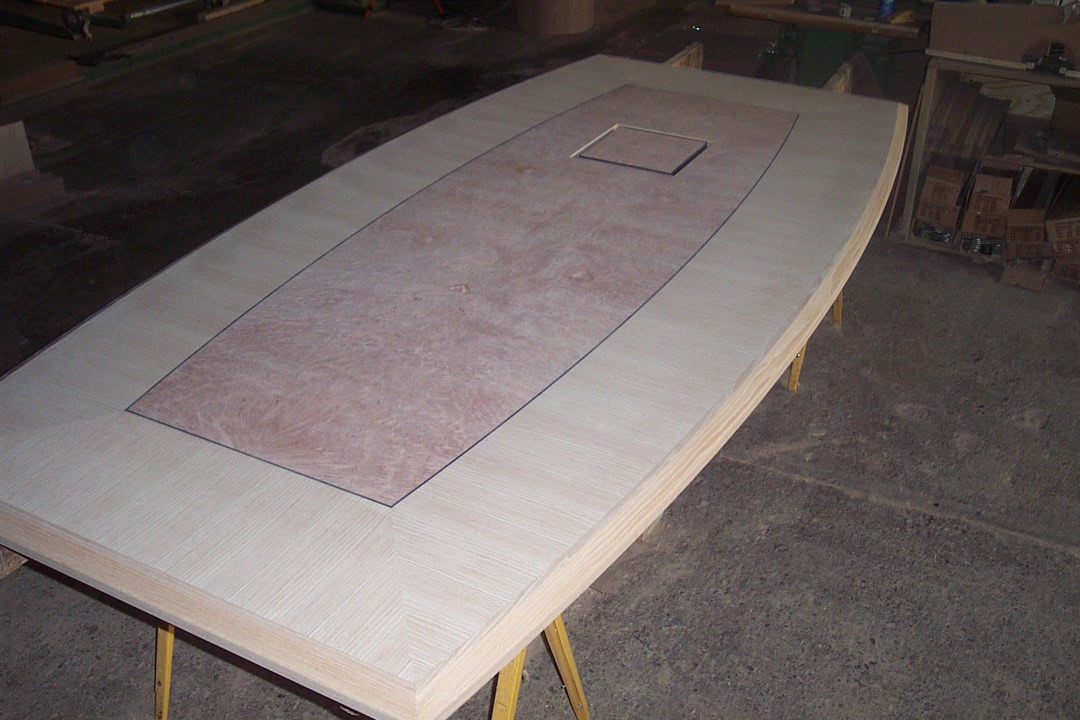

We are doing a large conference table
6' x 24' in a boat shape with flat ends. We are going to do a diagonal pattern match with grain running to the center and mirrored to the other half. They want to do a lighter grain wood and I'm looking for some suggestions for the pattern match. Originally I was thinking of something rift or quartersawn, but I'm afraid that may be to plain in the end. Also most of the linear grain patterns are in deeper grained woods like oak and I'm not sure I like that. Suggestions. This will be quite a project. we are going to make it in 6 ea. 3' x 8' sections as this will need to be transported to a second floor probably up steps. Bases of course will be detached so this should be manageable. Suggestions. I'm also possibly looking for someone to lay up the veneer sections. Suggestions?

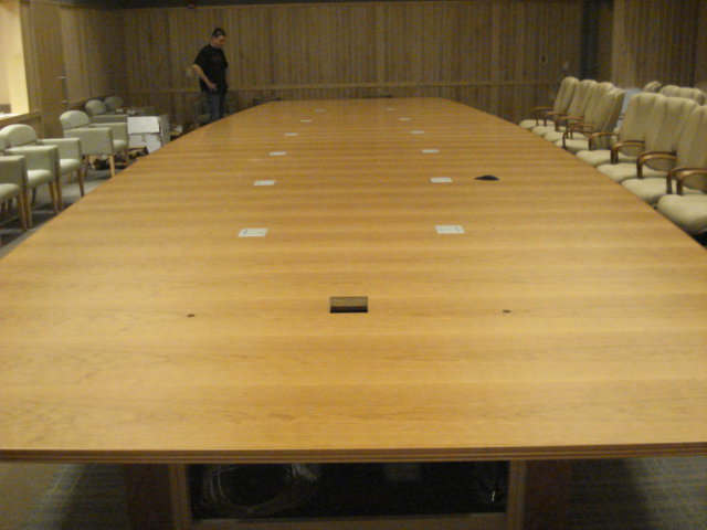

Dan: We do this kind of stuff all the time for both our customers and contract work for office furniture manufacturers. Contact me if you want a quote for the panels or the whole top. We are in Upstate NY.
