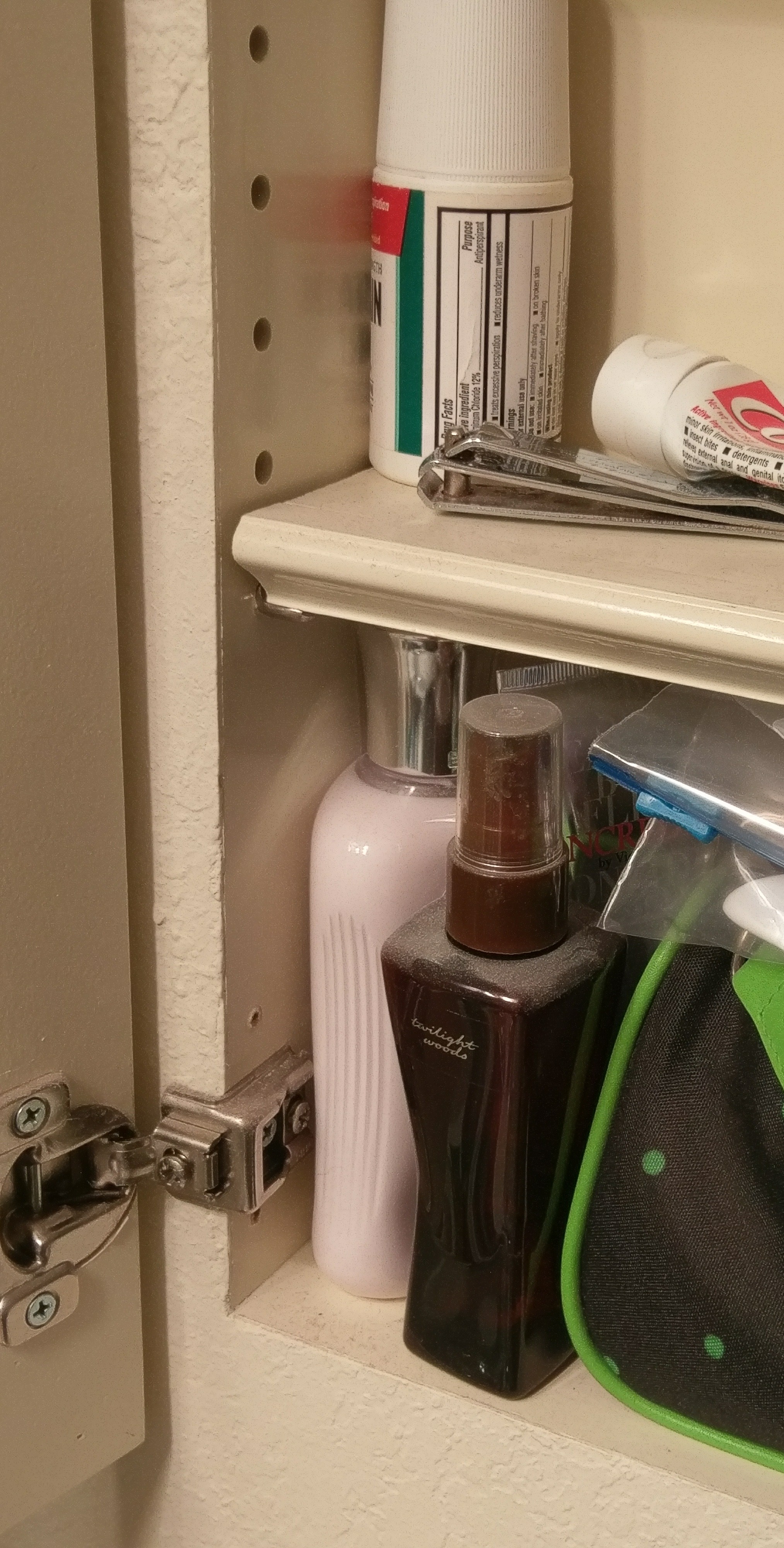

Steven
Pictured is a 1-1/4" overlay on a medicine cabinet where the box sides were just taped, bedded, and textured flush with the wall. Sounds like you're trying to do something similar. They should be pretty easy to source; these came from a big box outlet.
View higher quality, full size image (2027 X 4000)
3/20/18       #9: cabinet hinge for picture frame doo ...
Monkeyplumber
Hi Steven
I can work with that. Thanks.
