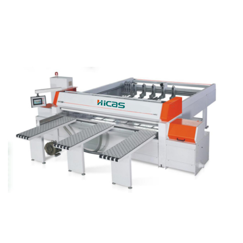

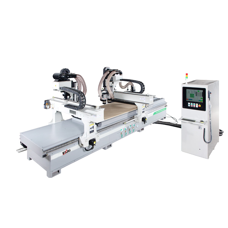

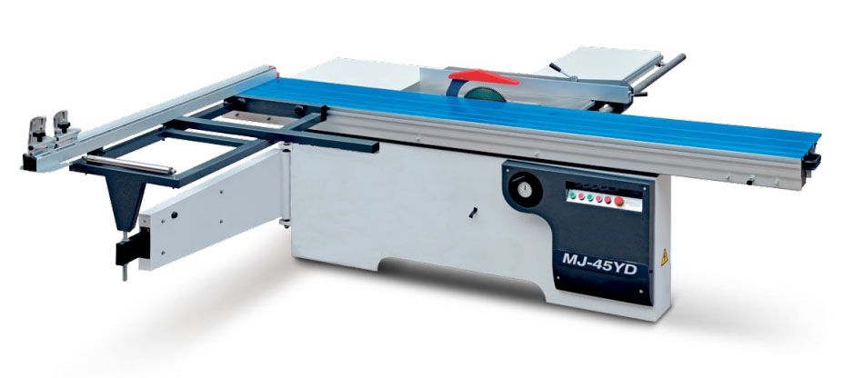

There are three categories I can provide for you. Slide saws, electronic saws, cnc routers. Of course, depending on your current production, it is up to you if you can choose among them. The factory's products, technical protection, service in place, you can look at the strength of this factory,
Https://www.hicasmachinery.com/atc-cnc-router-machinery.html
After consultation, make a decision.
