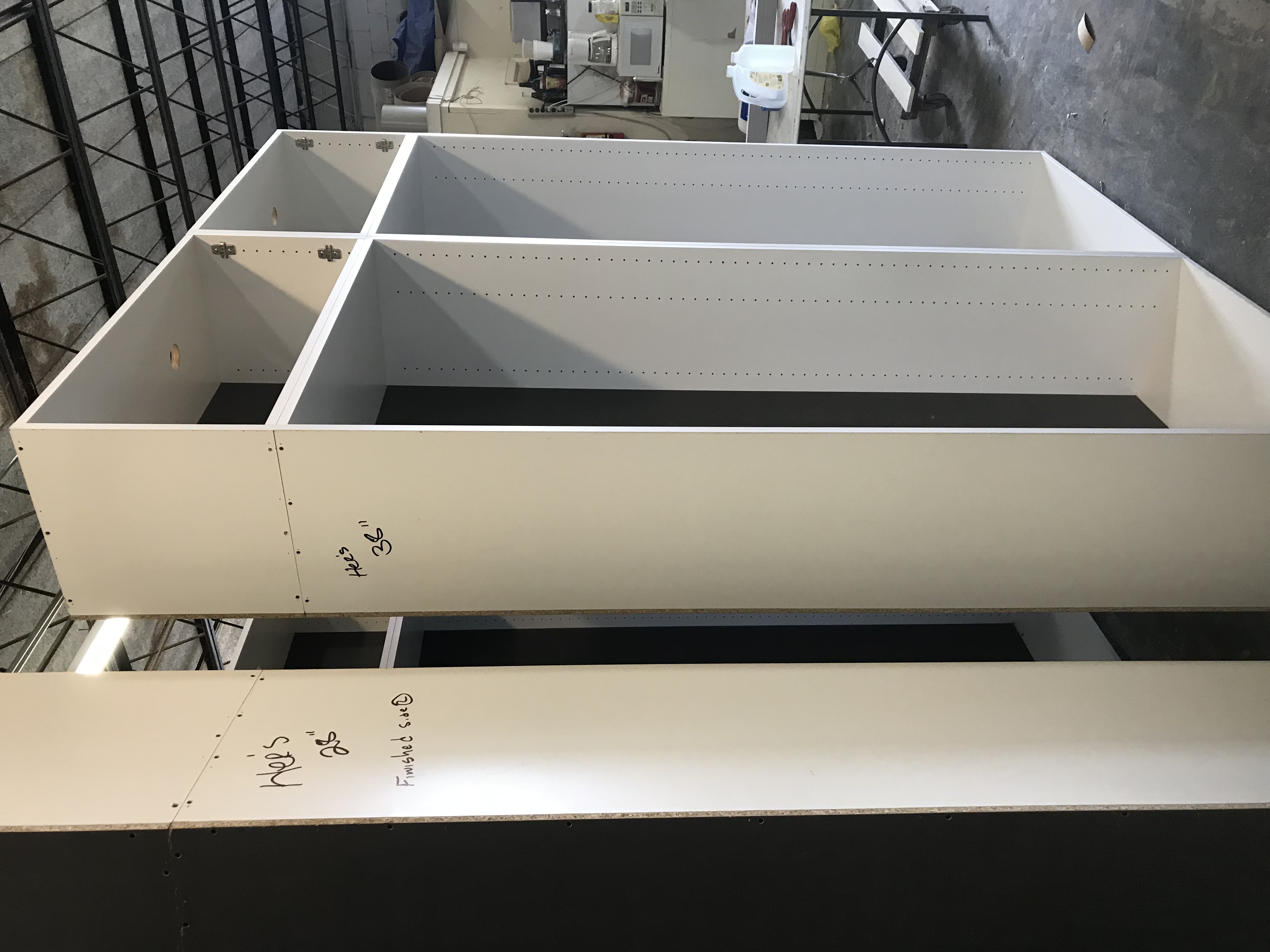

Hi guys, I am building 3 rooms of closets and the doors will be 5 piece shakers using 3/4” textured melamine for 3” stiles and rails and 1/2” matching melamine for center panel. Some doors will have a center clear glass panel and others will have the 1/2” center panel and some will have an 1/8” mirror glued onto the center panel, still giving a shaker look with about an 1/8” inset to the face of the mirror. I am planning to rip my 3” rails and stiles, band both sides of rails and inside edge of stile. Make a groove for clear glass in center of 3/4” , insert glass into rails and cap with stiles and use my lame lol zeta with the Tenso snap fasteners with polyurethane glue to glue rails and stiles. The Tenso will click in place and hold butt joint till glue dries.
For the 1/2 solid matching melamine center I will use my router table with hold down spring device and run a groove with a slot cutter the thickness of 1/8 Masonite registering from the back of the 3/4” and 1/2” material and join the whole door together with the same glue and Tenso joints at rail and stile. This will give me a flat surface inside the door or drawer front and then add the 1/8” mirror afterwords for the 6 doors that need mirror fronts. The drawers will be built the same way and mirrors will be added and handles will be attached to stiles to avoid drilling into glass fronts.

Hello, I have looked at the manufactured doors you referenced, I think they use a spline that matches center panel to hold rail and stile joint together , then they edge band exterior of door to hide joint.
I have made some mitered doors with clamex fasteners and glue with good results. just a small hole at the back. Maybe best to use tempered glass , I think 1/8 would be fine, the openings don't look too wide. How do you like that dust collector in the background of first photo?

Hi Ed, thanks for your response. The 2hp dust collector is not that strong. It’s working for us well for the two top/bottom trimmers on our bander. The premill is hooked up to a another collector at other end of machine which also collects from a slider. Should have bought a 5hp, but it’s doing the job. I have samples of these 5 piece shaker doors and had removed the banding to see how they are constructed. We use the tenso14 devices with our zeta machine and they do not need the hole in back. Those are designed for RTA cabinets. The Tenso devices snap together with a lot of strength.
We will be adding some poly glue for added measure. Thx, Harold.
