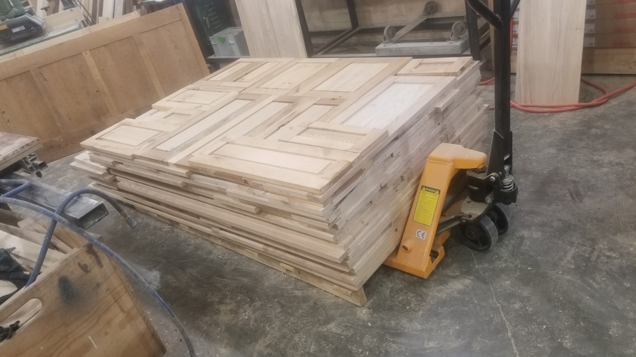

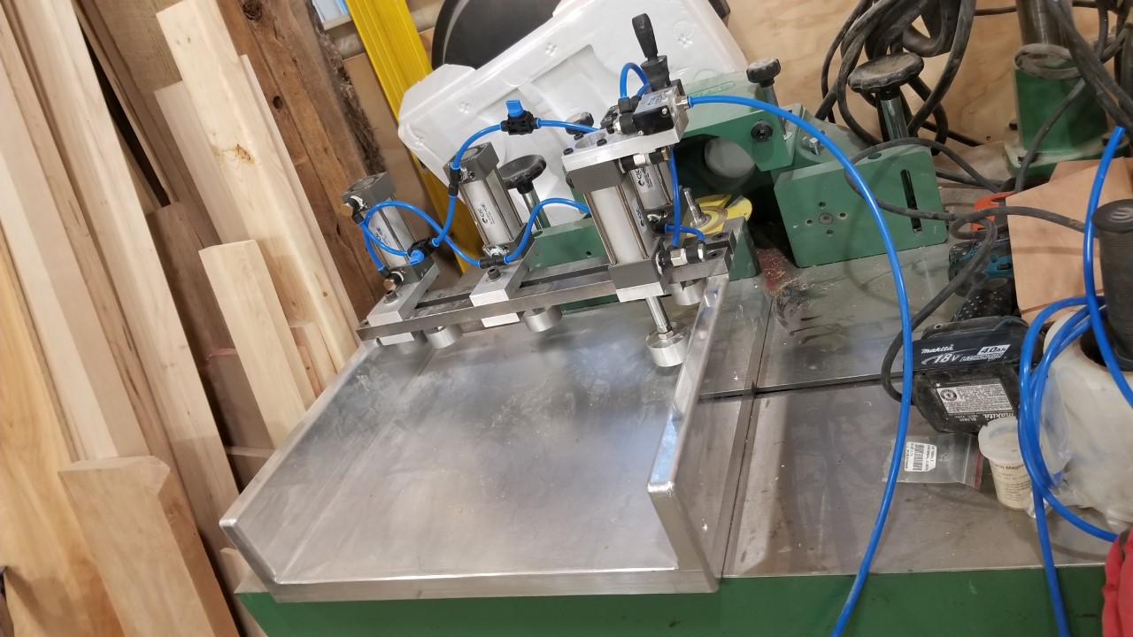

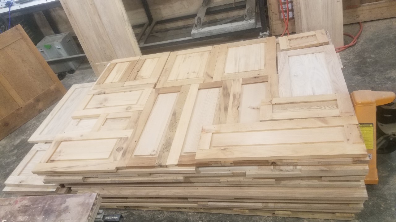

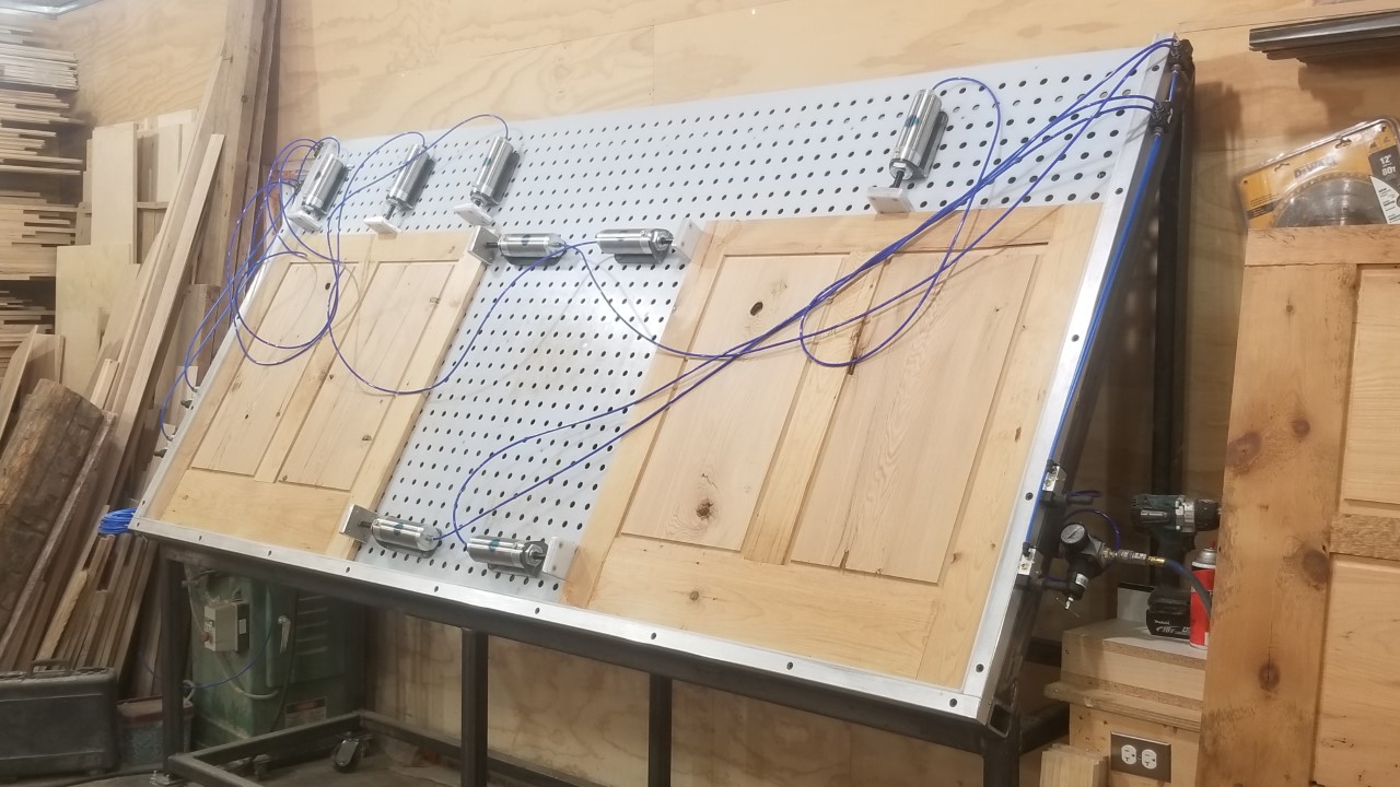

I build all my own doors and I have for the last 17 years. All are done on a single 1 1/4" General Shaper. The doors I am building I not able to buy as more and more I am into rustic material that no cabinet doors shops carry or they don't have anything close to matching! I typically will run 50-75 doors/drawers/gables in a run and it takes be usually a day for machining that amount. I made my own sled this past spring and its been a godsend and I don't know how I ever did without it! It does all my copes and also I use it for cutting the ends of my raised panels that are 20" or narrower instead of running them thru flat on the table because. I also built a nice door clamp this past winter at the same time as the sled and its saved me a ton of time. I did 278 doors, drawerfronts and gables and start to finish including maching and clamping was 4 days!!!! Average rate I was making for that run was $850/hr!!!! My previous glue up time for that many doors would have been a minimum of 6days...the new clamp was two days!
This is the first time posting on the forum in at least 6yrs so don't be supprised if I don't answer back right away if you have any questions...I will deffinatly try though!
Ryan

9/24/18       #6: Shaper questions for doors ...
RyanB Member
Sorry for posting duplicate pictures in my previous post

9/24/18       #7: Shaper questions for doors ...
Larry Schweitzer
Nice sled. What provision do you have for preventing chip out?
9/24/18       #8: Shaper questions for doors ...
RyanB Member
I run an aux screw on 3/4" thick fence. With both sides installed I get 20.25" inside to play with

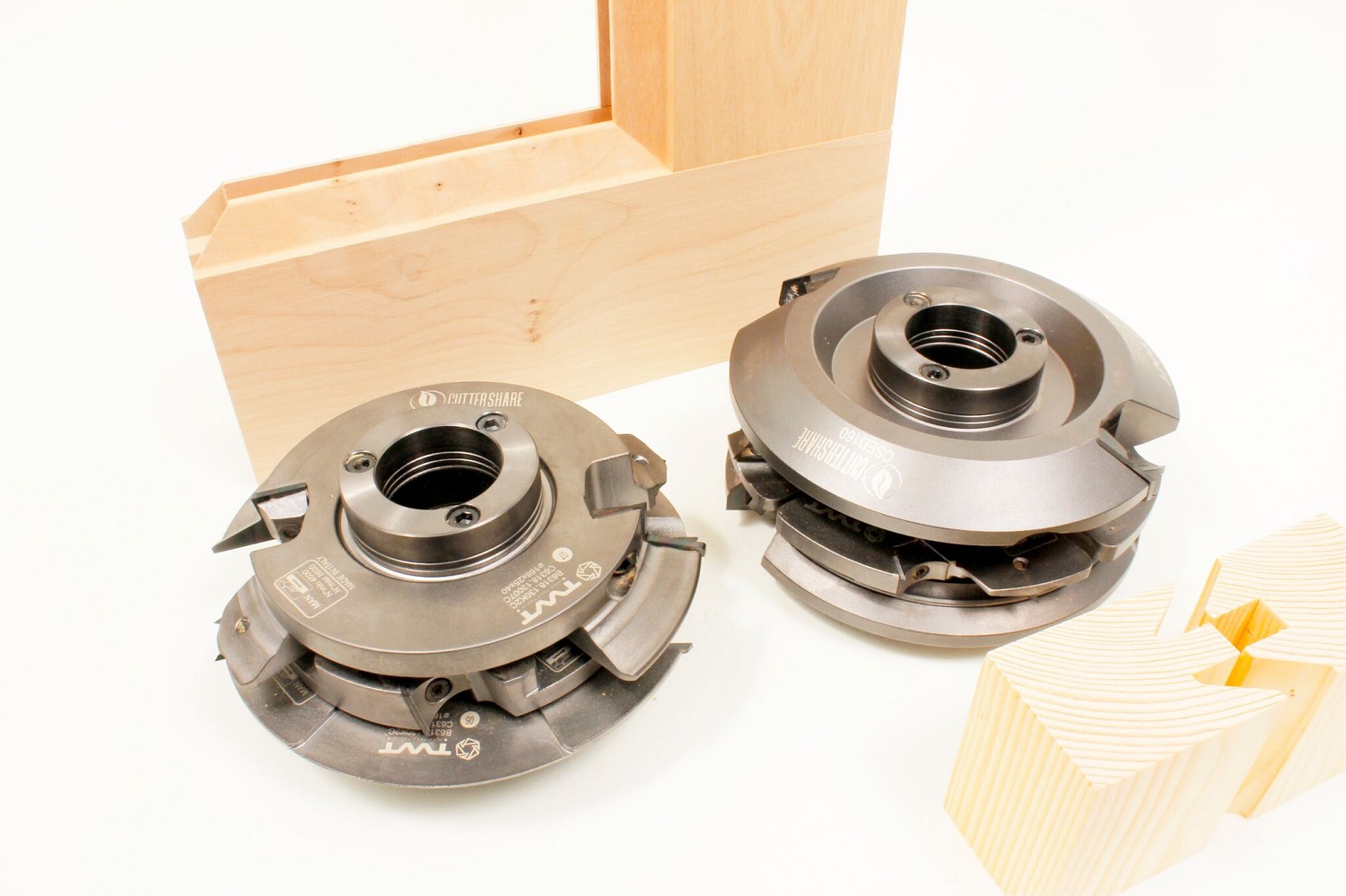

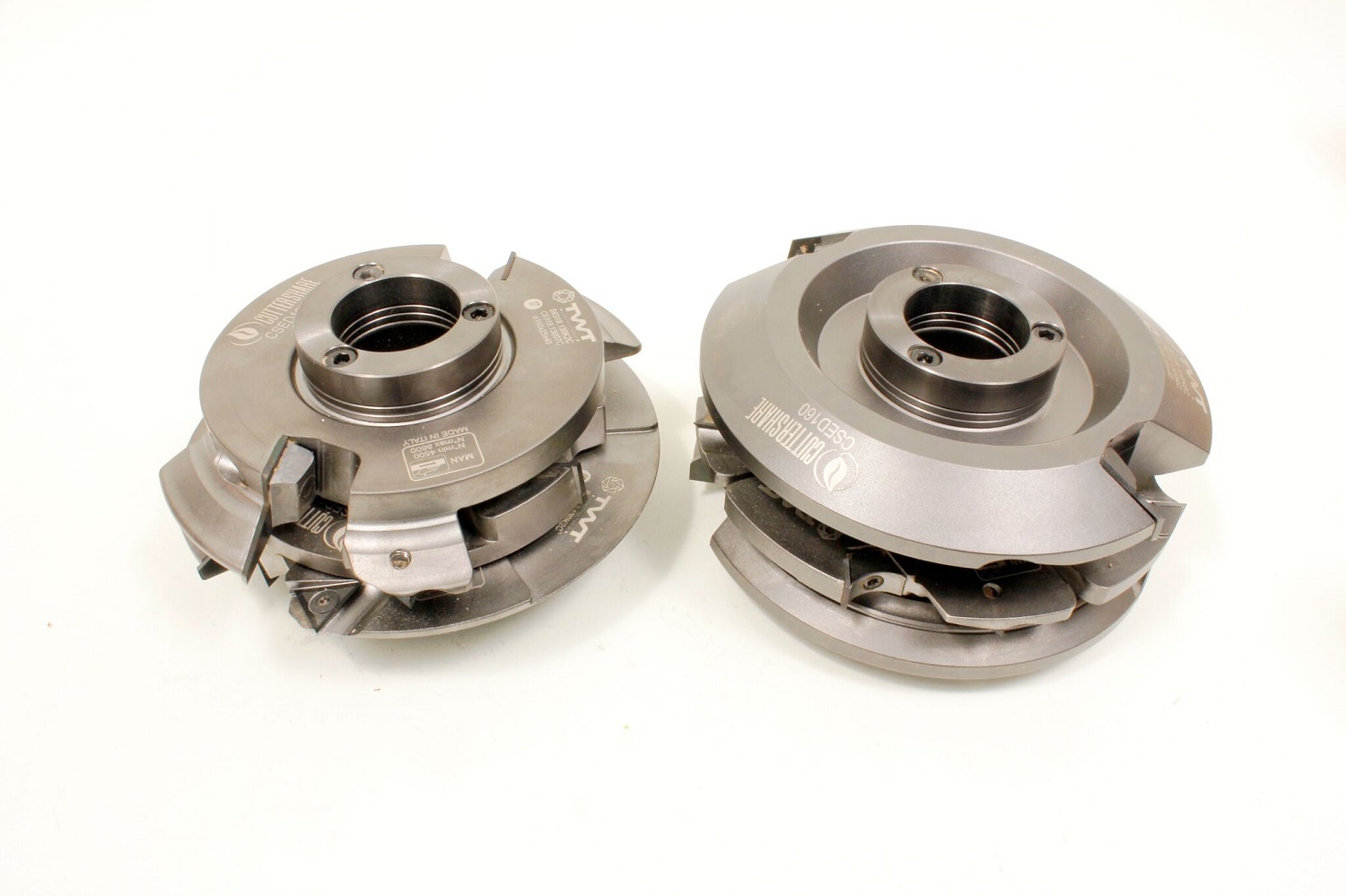

Alex Sponsor - Rangate
Website: https://rangate.com
Hey Jeff,
I work for Rangate (door/window shaper tooling is what we're best known for), so I talk to people in your situation pretty regularly. Like Leo said, using a set with the same inside diameter is the easiest way to do doors with a single shaper, since you're simplifying the adjustments going between tenoning and profiling cutters.
We have a program called CutterShare which we basically created exactly for your situation that I think would be worth looking at if you haven't tooled up yet. It would let you get our door set for way less than buying, plus you'd be working with the best tools available from the jump. (Obviously I am biased, but if you ask around about us, you'll hear the same thing). For something like doors where there's a performance component, it's definitely worth it to use good insert tooling. A brazed set is likely not going to match the profile to the counterprofile well enough for an exterior door after it gets sharpened.
A couple tips on the build process:
- Running the copes first will give you a better fit and finish. That way, if you get some blowout going cross grain, it doesn't really matter, since it gets removed when you do the profiling.
- When you do the profiling, offset the outfeed fence back 1mm to make sure you are taking a full cut.
We have a good video guide to the door shaping process here: https://www.youtube.com/watch?v=-XsU39Wak_o
Anyway helping people get up and running doing doors on the shaper is really what we do, so if you want to do a deep dive on it just send me an email and I'd be happy to talk.
View higher quality, full size image (1500 X 999)
CutterShare Door Set
