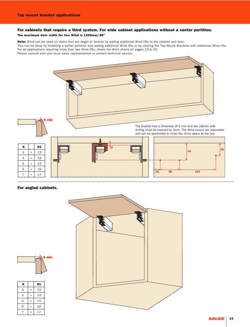

Does anyone have experience using multiple sets of lift up hardware on a single wide door?
The door is too wide and too heavy for a single set of Aventos or Hafele.

Salice Wind allows you to add as many hinges in the middle of the door as you want. The problem is if it's a frame and panel door all of the door weight is supported by the two frame joints on either end. The cabinet door might fail, but not the hinges.
6/1/19       #3: Multiple Lift up Hardware Sets ...
Hey Tom,
Here are the basics on the Salice Wind for wider doors. Wind can also be top mounted for applications where the side can not be used to attach the hardware. Please let me know if you would like additional details. The link below will take you to our web site with all information.
