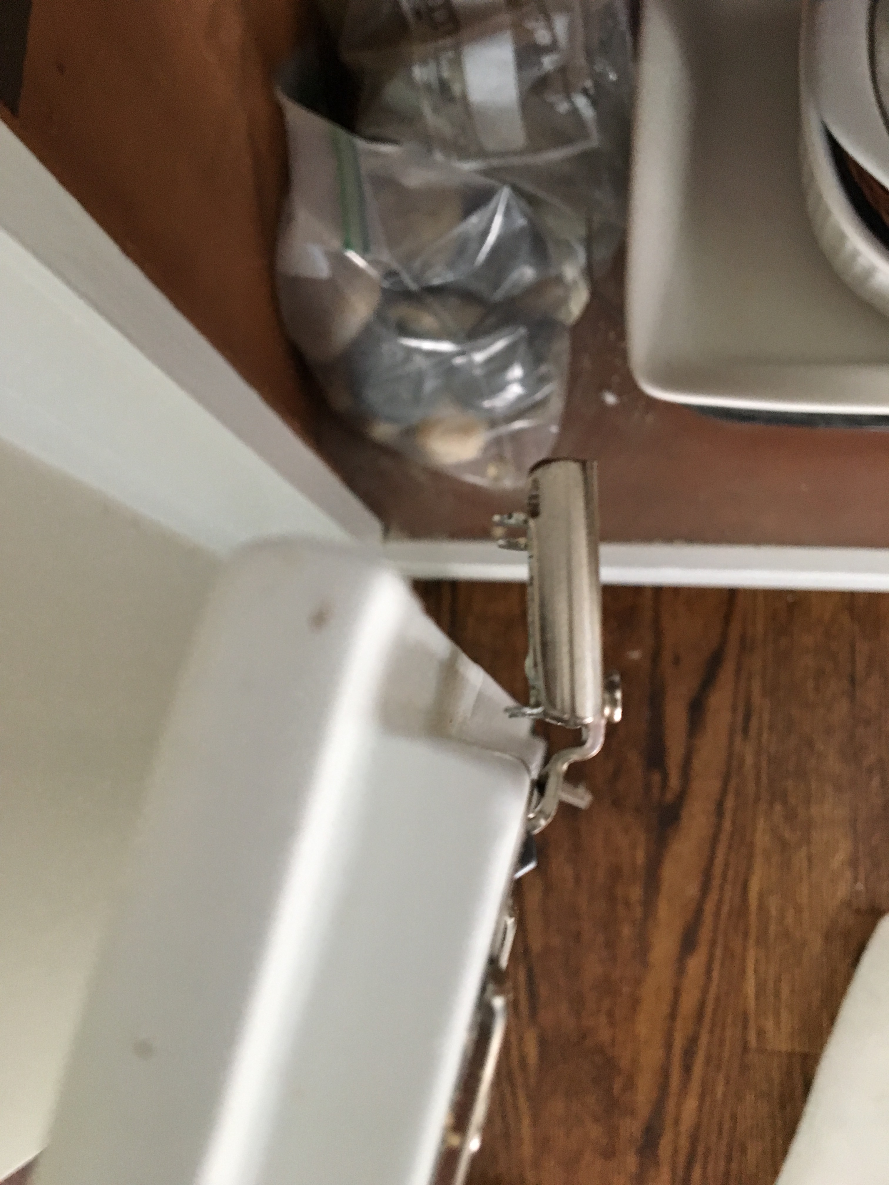

So I ran into a problem today trying to re-hinge some doors for client. The doors are overlay but they are rabbited around the back so the actual door sits in the door opening. I ended up drilling out one door and installed the blum face frame hinges on it. Then I realized that the rabbit was going to be in the way. Does anyone have any solutions? Also I'm trying to use face frame hinges because I am trying to avoid padding out all the cabinet behind the face frame.

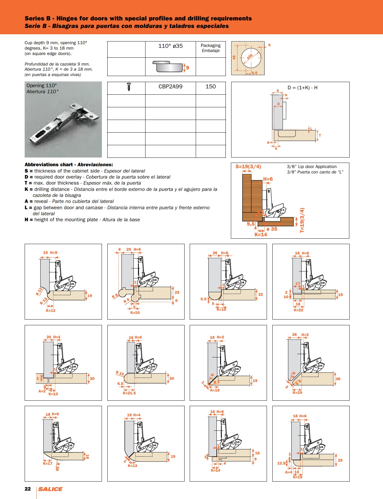

Hi Jake,
You will not find a one piece face frame hinge for for this job. Your solution is the Salice Series B hinge (CBP2A99) for profile edge doors. You will need to build out the back and use a 6mm mounting plate (BAR3R69).
There is also a soft close damper for this hinge if your customer would like soft close doors. (DB01SNG)
Here are some details.
Best of luck,
Dennis
