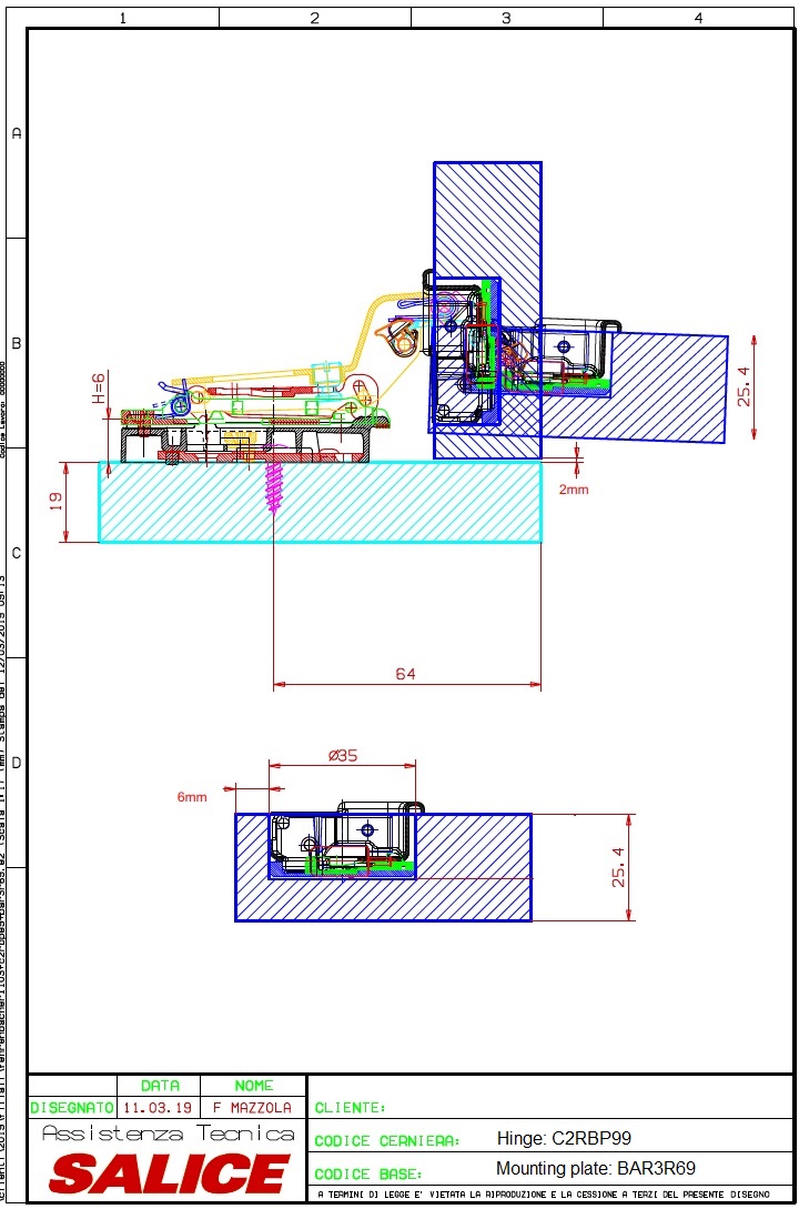

This question is for Dennis Bean. I have 1"thick doors that will be inset about 1" on the back of a display cabinet. Cabinet is build euro style.
What cup and mounting plate should I use?
Thanks, Bob
6/26/19       #2: Salice hinge & plate ...
HI Bob,
One solution would be to use an inset hinge with a 6mm mounting plate and a 6mm edge bore distance.
Hinge (With dowels, self close): C2RBP99
Mounting Plate: BAR3R69
Here is a drawing with a 1" door.
Best of luck,
Dennis
