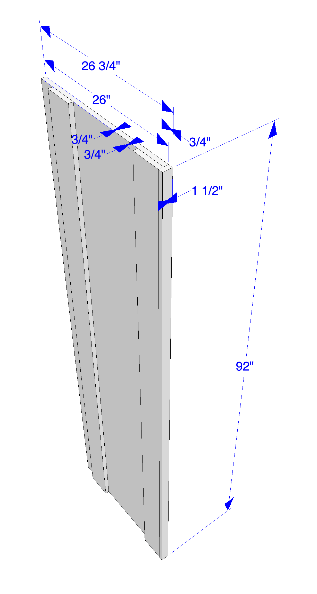

Goes to outsourced finisher (an hour north of me) as a flat panel and arrives at jobsite in banana mode. We glue (TB1) and nail the 3/4" "furniture return" strip on the back and then glue and clamp the 1 1/2" nosing on (just like a built up countertop). Imagine this is an end panel capturing a fridge. This has happened with paint grade and stain grade. Material is usually 3/4" classic core and solid nosing. The curious thing is that sometimes the panel stays flat and sometimes not. Vas in ze vorld?

We will make end panels like these when they are anchored to a box. If they are not, such as in the case of a refrigerator side panel, we will make these as balanced torsion boxes. I would expect this panel to warp with or without finish, in every type of sheet good. The reason is that it is unbalanced.

I'd narrow up those build up strips and see if that helps. What you don't know is how the finisher handled them. Does he prime and finish one side, then let it sit for a couple days? That allows moisture exchange on the unfinished side.

- Width of the strip of ply on back is usually 6" (as most fridge specs Ive seen say 4" furniture return... visible part back of panel when fridge door is open).

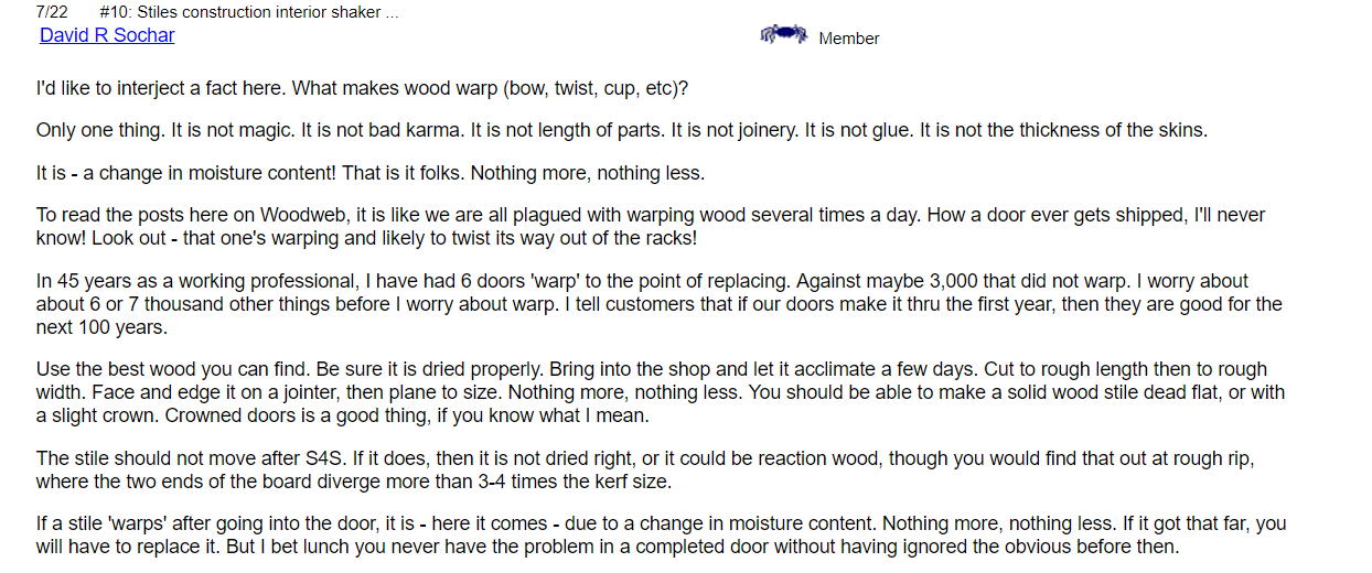

- As far as David's screen shot comment, we are talking plywood here (mostly), but just to get a little off topic, it seems a real problem in this line of work is IDENTIFYING "reaction wood" as 90% of wood deflects/opens/closes as it moves through a spinning blade releasing tensions in the wood. This is why sneak up on the rip. first wide, then to size before committing. Am I wrong?
- Lastly I was thinking if the panel is 3/4 glued to 3/4, it'd be more balanced than 3/4 strips glued to a 3/4 panel (surface tension?)

"....lean or stack a panel potentially causing it to bow" Nope - that will not do it.
"Final verdict for future searches: INCONCLUSIVE" Nope - that is inaccurate.
Prayers, crossed fingers, chicken blood under a full moon, black cats may all have their effects, but none as strong as moisture content change for a culprit.
It is the MC boys. Nothing more, nothing less. If it is going into a museum environment, with absolute constant temp and Relative Humidity, and you shop matches that, then you can ignore wood movement.
Other than that, and it moves, it is MC. No more, no less. You do want to keep the finisher on his toes for his part of the balancing act, but mostly it is your job to make it balanced.

I would look at how much finish is applied to the edges of the plywood rippers.
When sealing you need to think of all 6 surfaces. Plywood edges soak up moisture much faster than the faces. The faces typically get coated more so it makes the situation worse. You have 3 exposed long edges on one side that might not get enough sealing.
What is the 3/4” x 1 1/2” wood?
The order of construction can make a difference as well. If you edged the panel first, then glued the rippers on second is different than glueing the rippers on then bending the wood edging and/or thickened panel together.
I would ask the guys in the shop if they have been consistent in the manufacturing steps.

Brilliant ideas Adam. I never thought of any of those. Ply rips go on first then the solid 3/4x1 1/2" wood edge.
