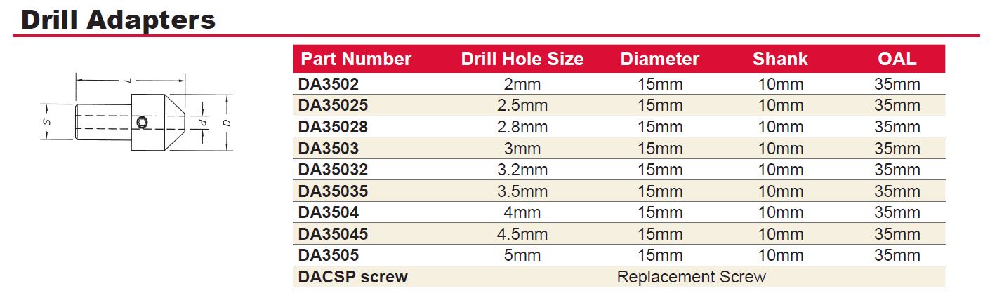

9/12/19       #4: Dowel drill adapter ...
We can help with some sizes.
View higher quality, full size image (1410 X 428)
