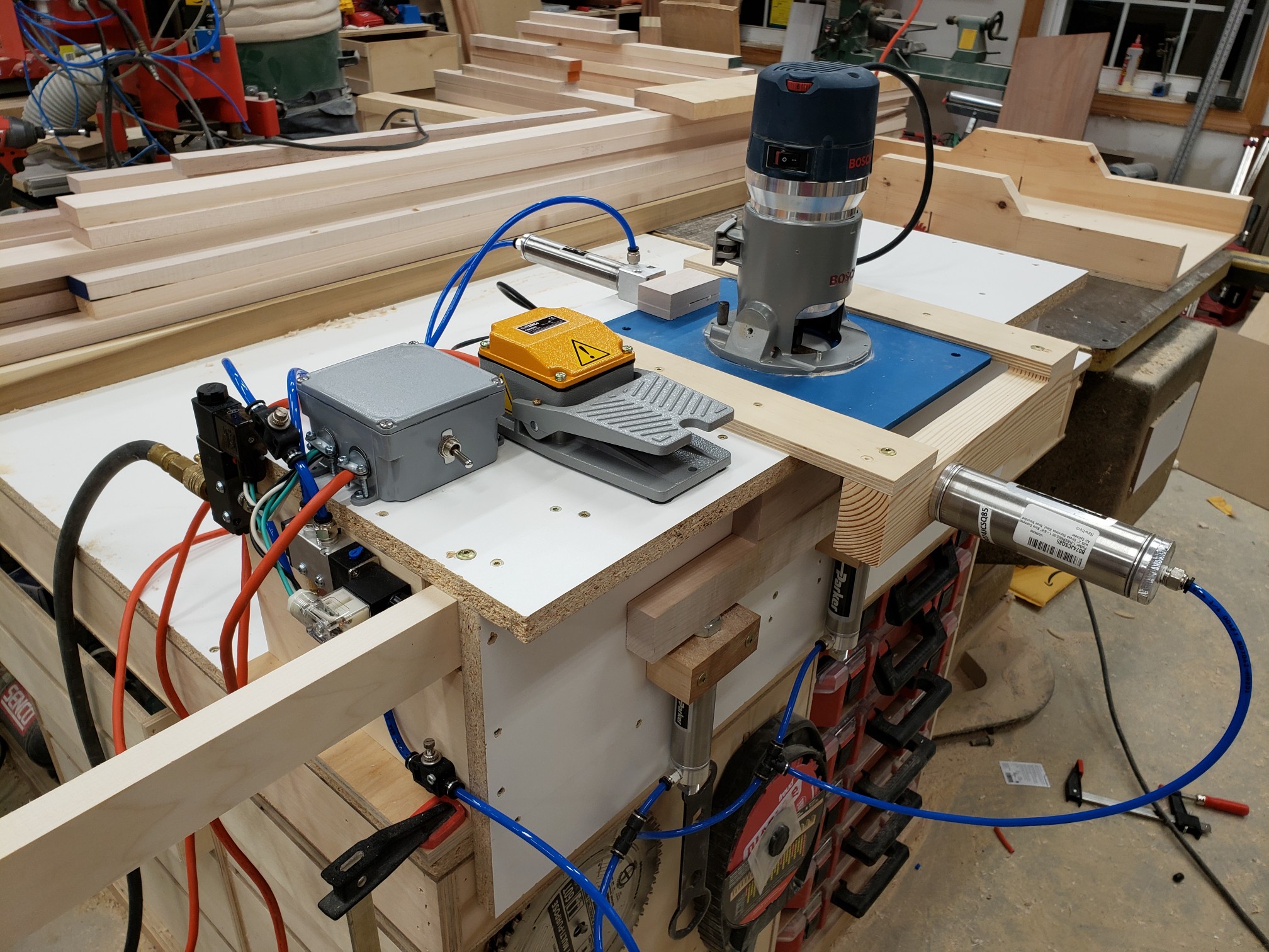

I've been playing around with building a face frame notcher. Its basically built like a hinge borer and uses a router with kreg bit to cut the actual notch. Its built from scraps around the shop and about $100 in pneumatic cylinders, solenoids and switches.
I'm curious what people think?

I like it! You get an A+...

Looks like it works well.
I'd take your plan and step it up with some linear guides of some sort just so it stays tight and accurate long term.

Very nice. I agree with the linear guides. What is your plan to line up the work? Tiger stop? :)
