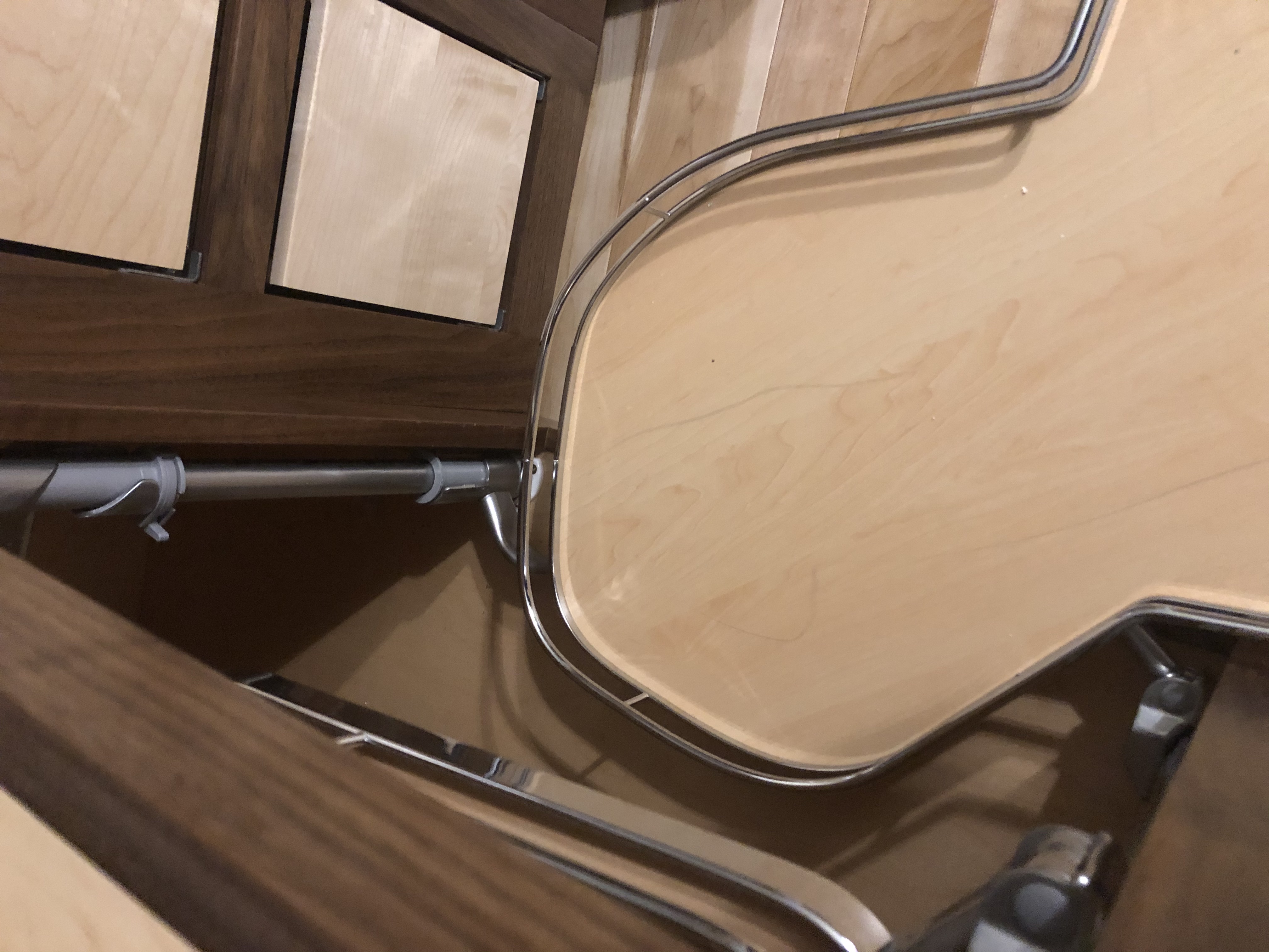

I am designing a kitchen using inset 1" thick face frames and doors.The designer has specified a lemans corner. The literature for the lemans corner seems to say 3/4" thick is the maximum face frame thickness allowed. I am wondering if anyone else has run into this issue and has a solution?

Hi Tyler,
While I only build framless, so this is kindof a shot in the dark. If you dont put a reveal on the inside of your cabinet and leave the frame opening flush with the cabinet side it should work. Ive installed many of these in our framless cabinets, what is more important is the size of the post the door hangs off of.
1/29/20       #3: Lemans corner 1" Thick Facefra ...
jbid Member
It would be really close. The issue is that the post mounts directly behind the face frame and there isn't an extra room. If you just install it behind the 1" frame, the shelf looks like it may hit the frame during pullout.
I'd make the frame for that cabinet 3/4" and flush the face to the other boxes. I don't think the 1" door will be an issue.
If you do use a reveal on the inside, you'll need to add spacers behind the bracket to flush it to the face frame edge, or just build it flush like Nathan suggested.
