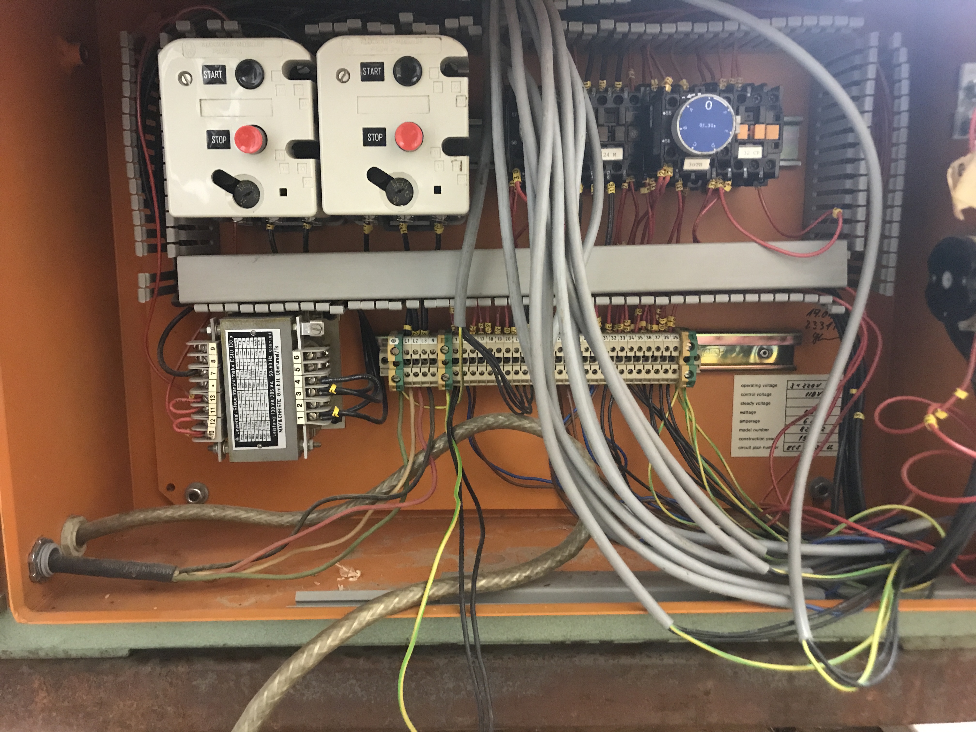

Wondering if any of you guys have ever used or know of a Holzma hinge borer? I just picked this up last week, and while everything works great, I can’t get the foot pedal to work. I did trace the appropriate wiring in the electronics box, but there are four separate contractors, and over 30 labeled wires and it’s above my pay grade. I contacted Holzma, but seeing as how this is an ‘82 model that’s no longer made, I’m not too hopeful. Any info would be appreciated, and I can pay for help if anyone is in the Columbus, OH area.

I would start with the switch at the foot pedal. Most likely it is a normally open switch that closes the circuit when it is depressed. Verify that it is working properly with an ohm meter. Disconnect the power first, of course.
It could be the switch itself, or the wiring.

I am guessing that is a well made machine and that cleaning the contacts on the foot switch will solve the issue. I have foot switches on several machines and when they stop working cleaning has solved my issue.
