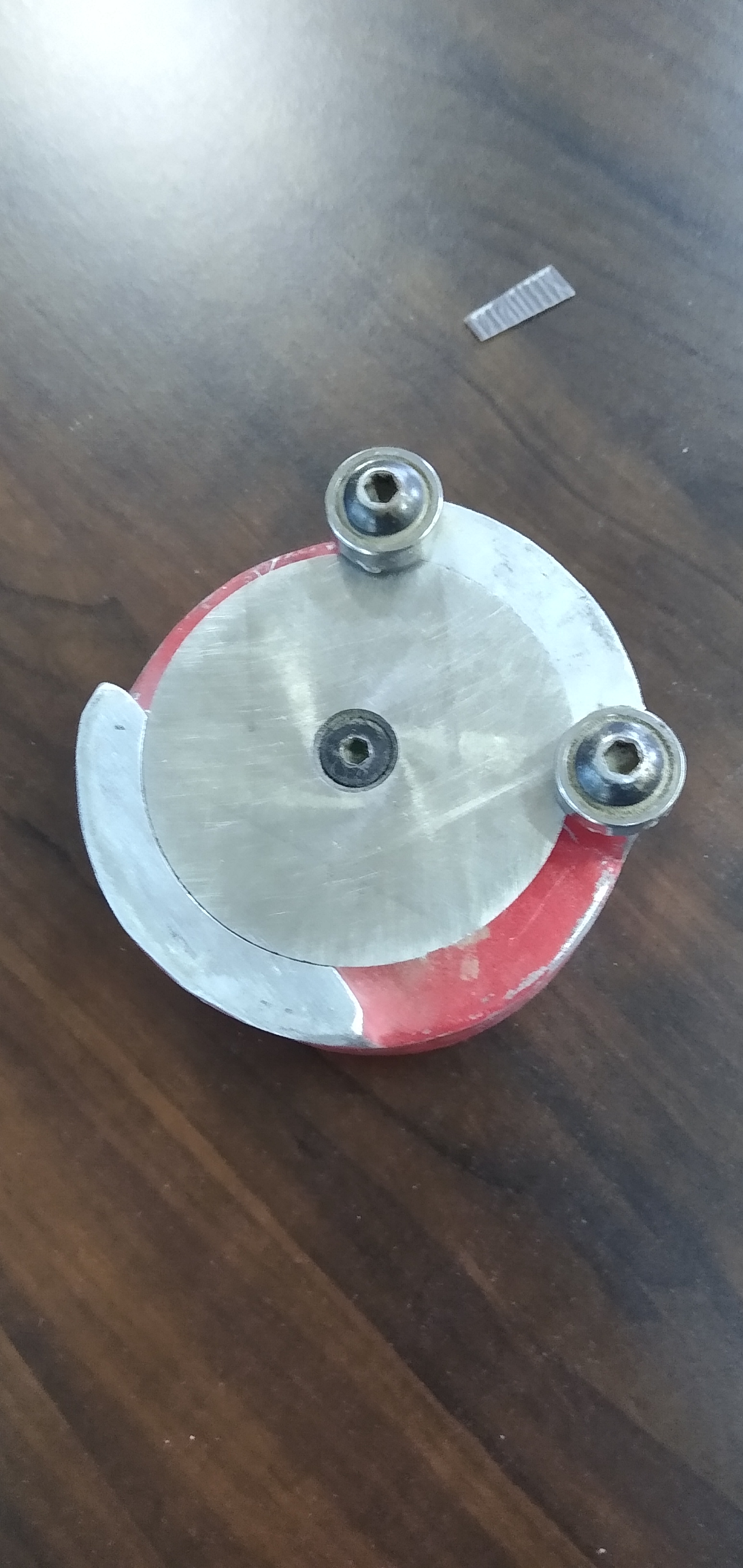

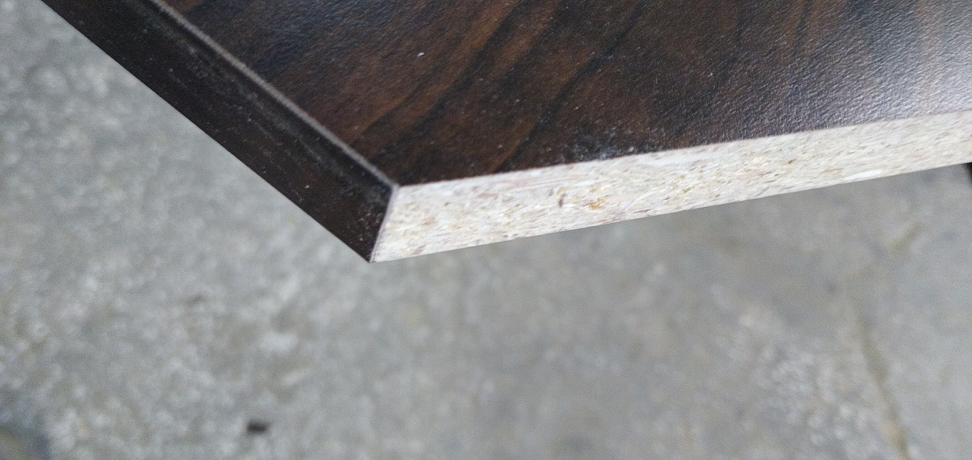

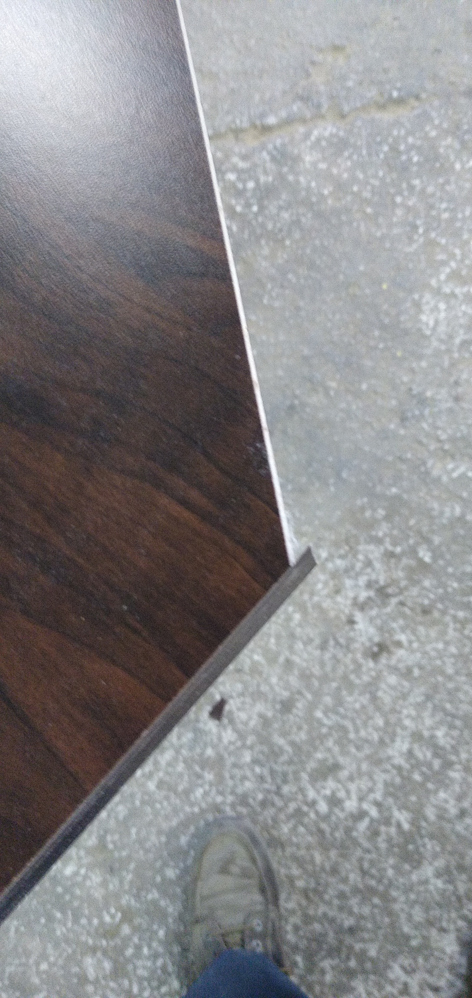

Quicktrim
This little puck trim tool works great up to 1 mm
View higher quality, full size image (1546 X 3264)
View higher quality, full size image (3264 X 1546)

SNX Technologie - L'il Pucker

Quicktrim could you post a short video using this on end trims? Very interesting - didn't know this was out there!
