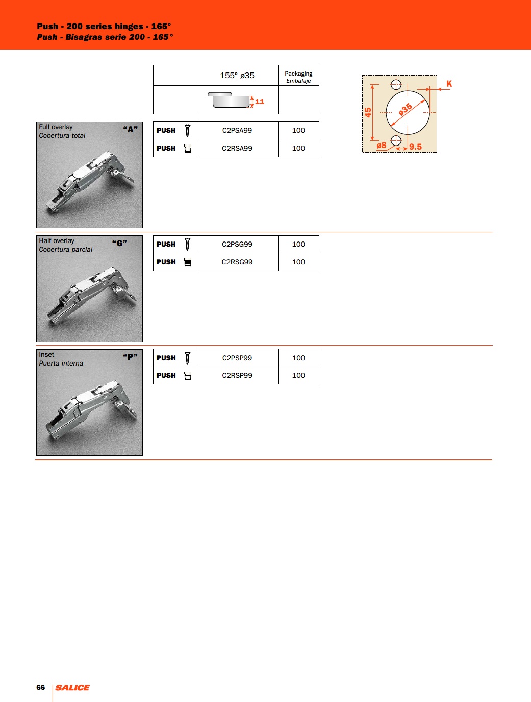

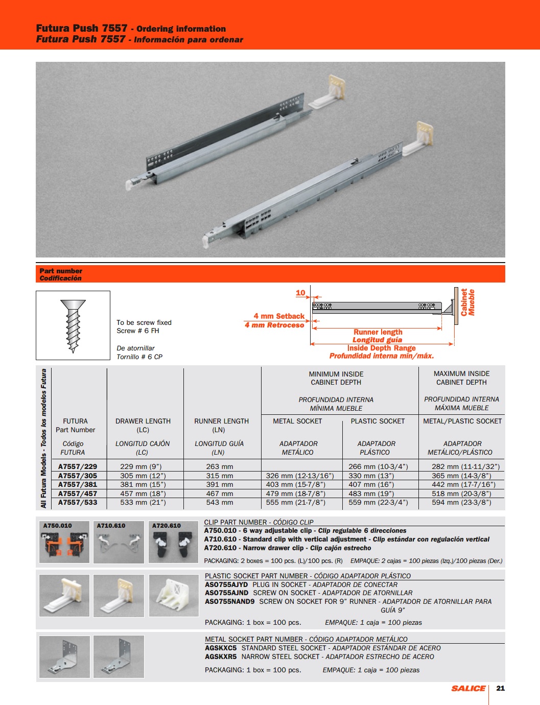

This is mainly for Dennis Beam. I build faceframe cabinets with 1/2" overlay doors & drawers. Customer wants no hardware on fronts. Could you give me the part number for a 155 degree hinge that is push to open and also will the push to open drawer guides work on a overlay operation. If so, what is the part # for the 21"guides? I use the rapido hinges on my typical doors. Will I need to also use the push to open magnetic catch on the doors? Thanks for your help.

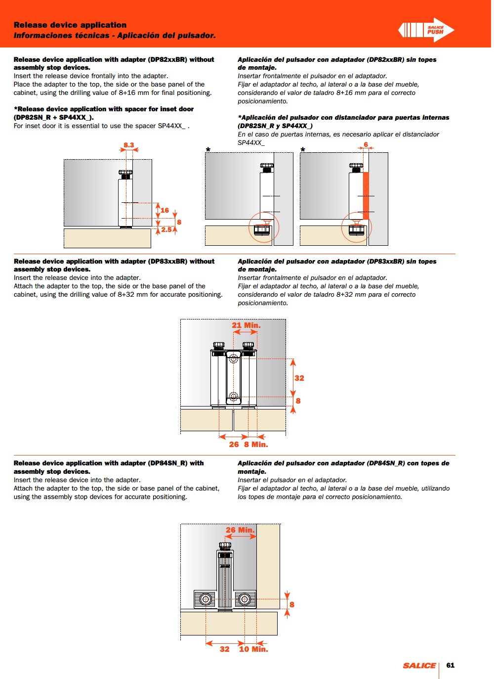

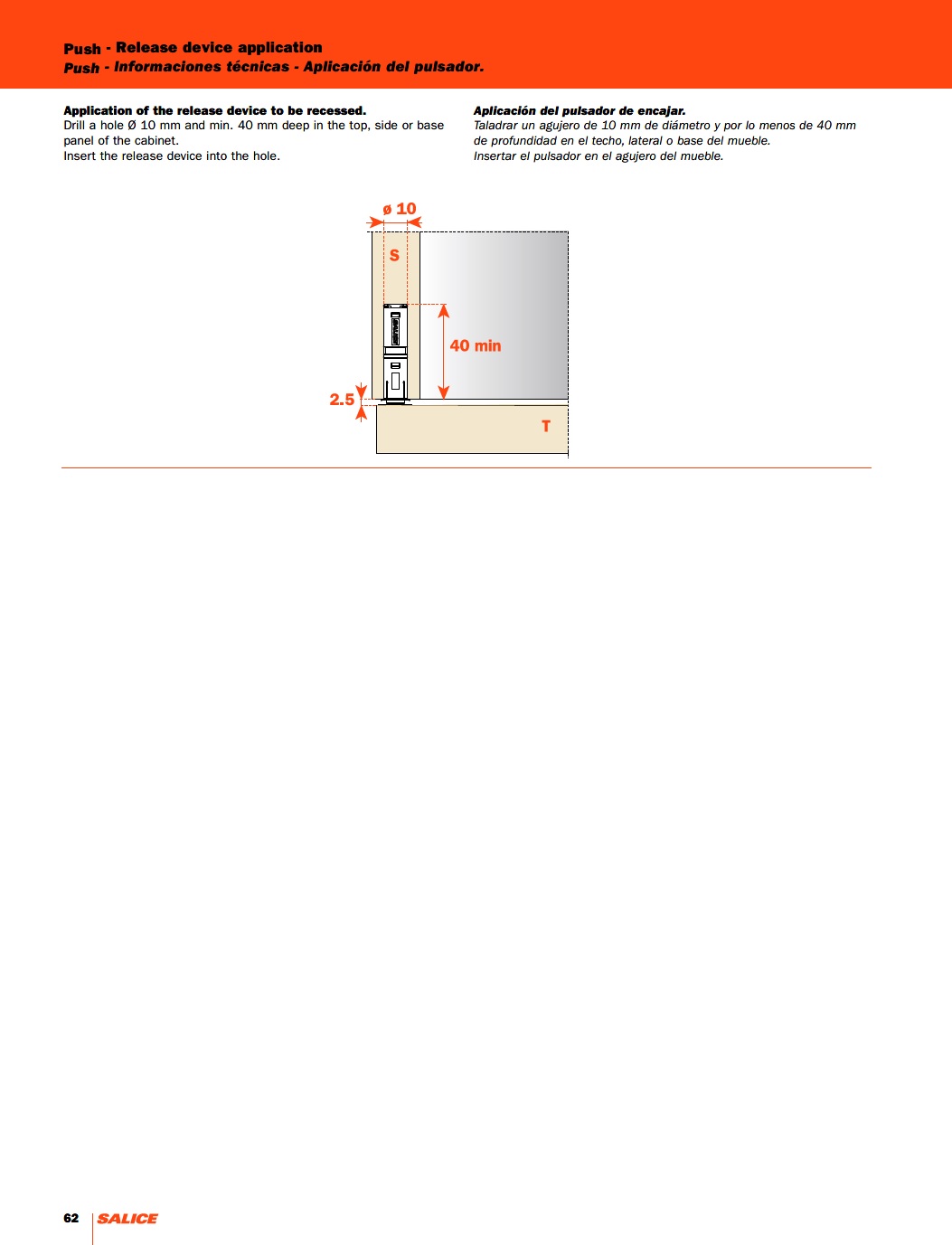

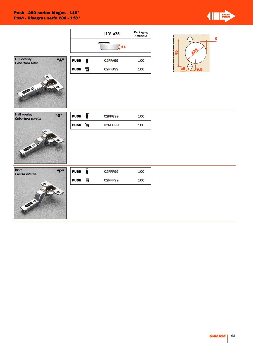

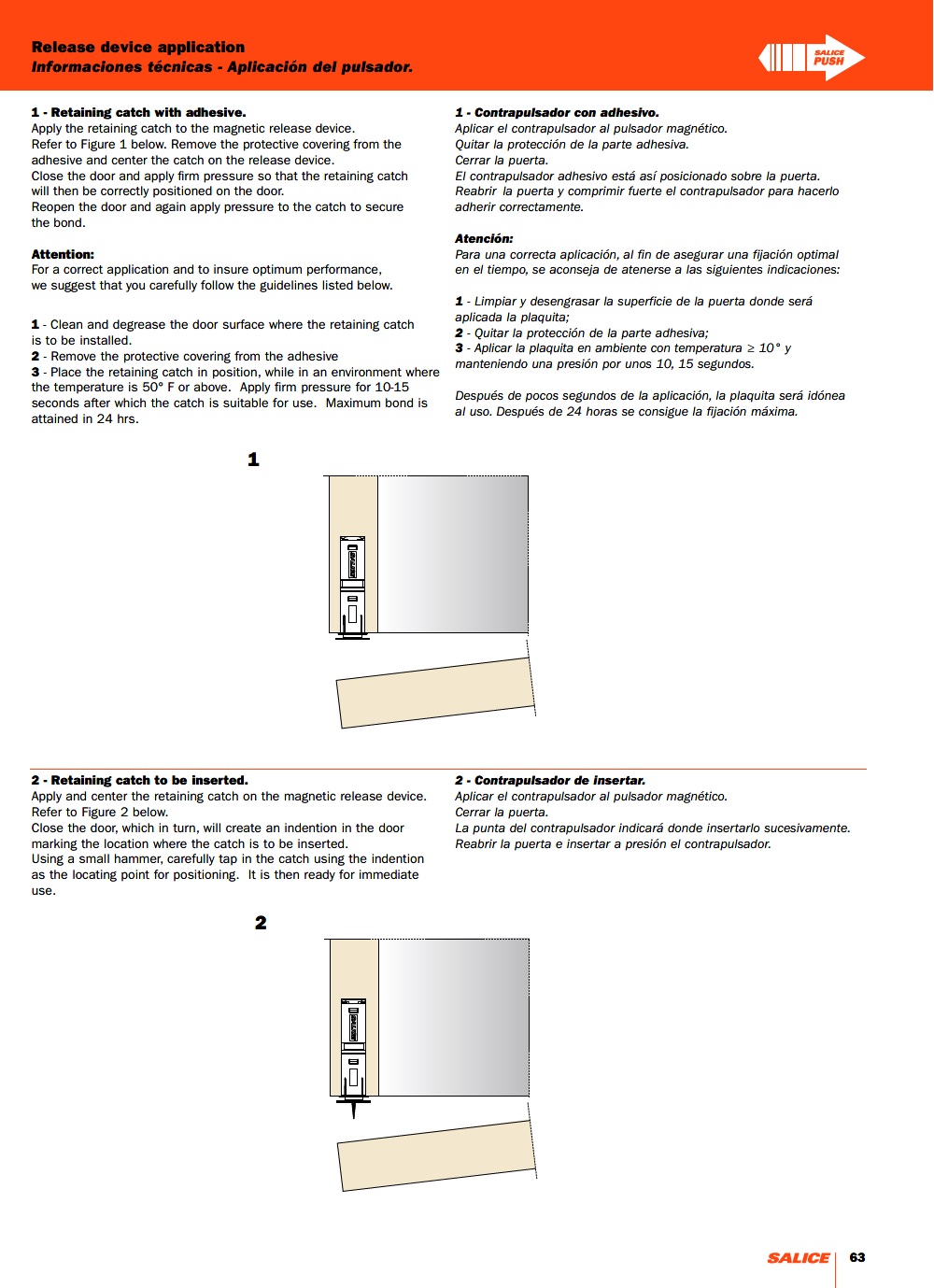

Hello Robert & Leo,
I will answer the hinge question first. For the Push hinge (self opening) you will need both the hinge and a magnetic release device. The magnet does 2 things. First it holds the door in the closed position and second, it acts as a release device to begin the opening movement. The magnetic release device can either be recessed or it can be surface mount.
Here are the catalog pages for the Push hinge and for the release device.
For the tip-down sink front, there isn't anything specifically for this but the 110 degree Push hinge with the recessed magnet is frequently used due to the compact, discrete appearance.

3/30/20       #4: Salice push to open doors and drawe ...
More on the Push hinge release devices.

3/30/20       #5: Salice push to open doors and drawe ...
Push to open drawers:
A7557/533CP6 - 21" Push drawer slide
A750.010 - 6 way adjustable front clips (pair)
AGSKXC5 - Metal rear socket (each)
6 pair per box.
Front clips and rear sockets sold separately

Hey Robert,
I just noticed you have 1/2” overlay doors. For this you will use a full overlay hinge and a 6mm face frame mounting plate.
Hinge: C2RSA99
Plate: BAU3R69 (New from Salice)
