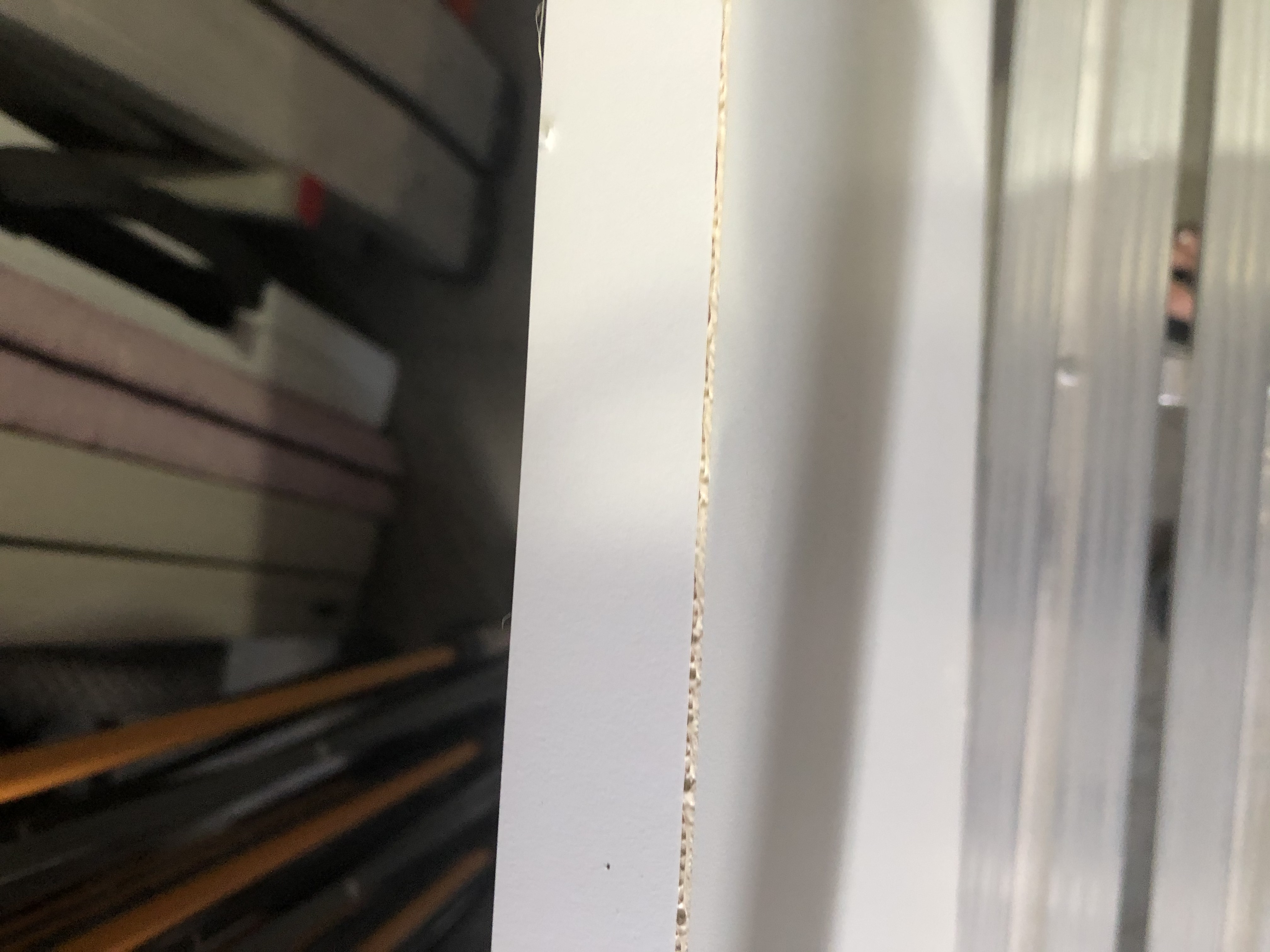

Just looking for tips/feedback on Maksiwa edge-banding. I bought one recently and tried small shelves - it worked well. I tried a larger piece and the edge-banding looks very bad. It is shifted from top to bottom and not consistent. What do I do wrong?

On most banders (not familiar with this).Whatever guide is holding the banding in place (down) before it hits the panel is set too high. So on longer panels it starts riding up leaving the bottom exposed.

I've got the same machine. Works well but with no feeder, you really need to keep your part pressed flat on the table. That can be a task with 8' not so flat plywood panels. Infeed and outfeed tables or roller stands let you focus on keeping the part pressed flat where the tape is being applied. I actually mounted a small power feeder on my machine to help with this, although it didn't work as well as I had hoped.
