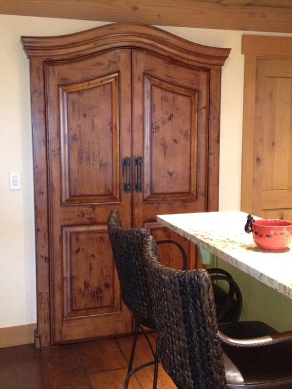

duster
I did this entry to a walk in pantry using 5 blum hinges per door. They were mounted to the jamb which I included. It was for an out of state job, clients contractor installed it. That was 10 years ago, no call backs...
View higher quality, full size image (600 X 800)
