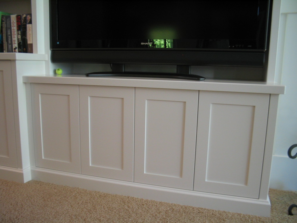

I use ~1-1/2" (typically just the top edge + blocks for clips) molding/toe kick wrapped around with the FE sitting on top.
7/29/20       #7: Euro Cabs with furniture toekick ...
Very unlikely that I will be using a wrap around base as the toekick+.
Looks nice.
