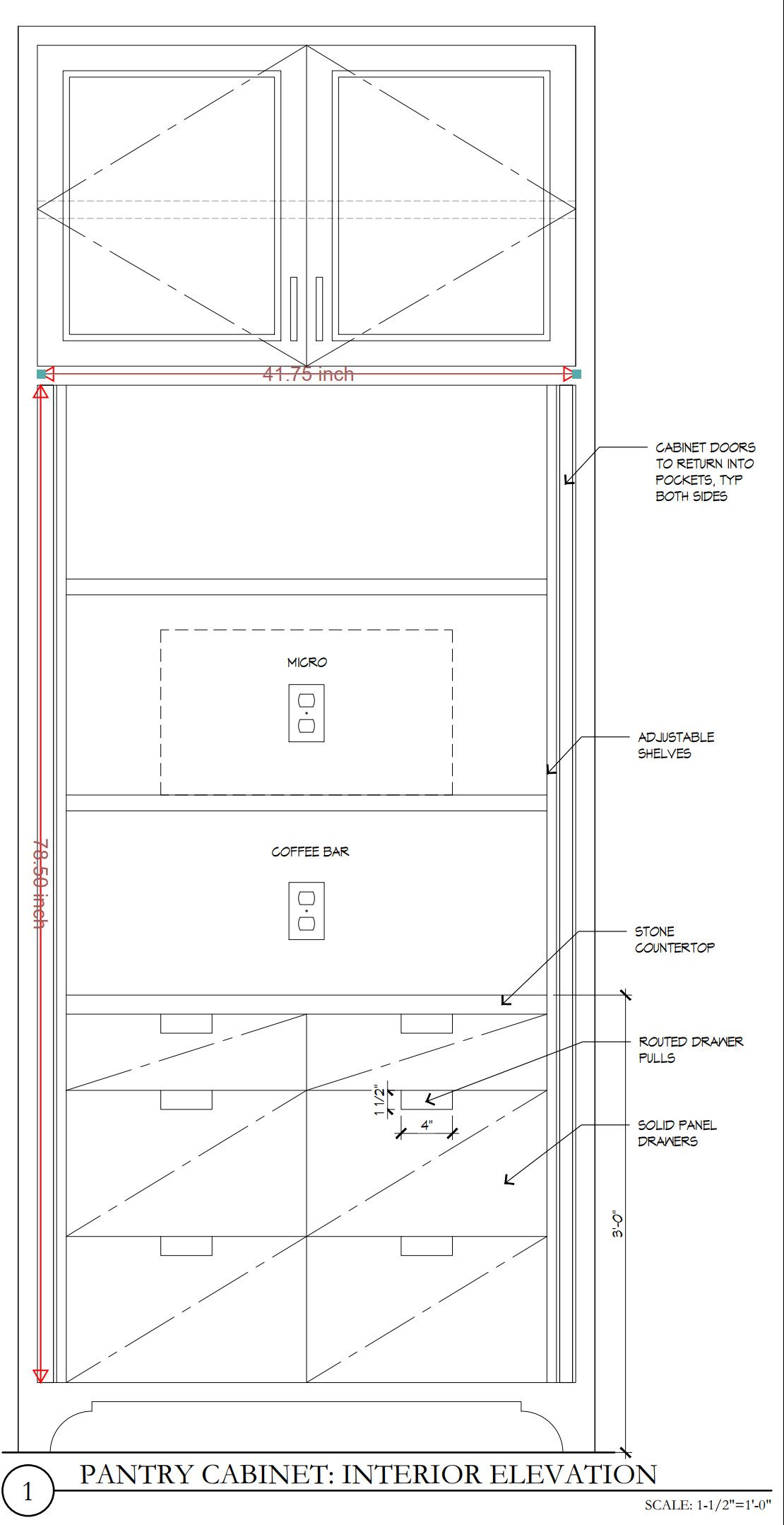

chris
KV? Accuride? The wheels rubbing on the face of doors is what concerns me the most.
Any suggestions of something decent that won't break the bank?
Hafele concepta (I think its called) scares me of how involved it is
8/12/20       #2: Retractable pantry doors ...
chris
Forgot to attach the drawing
View higher quality, full size image (1110 X 2158)

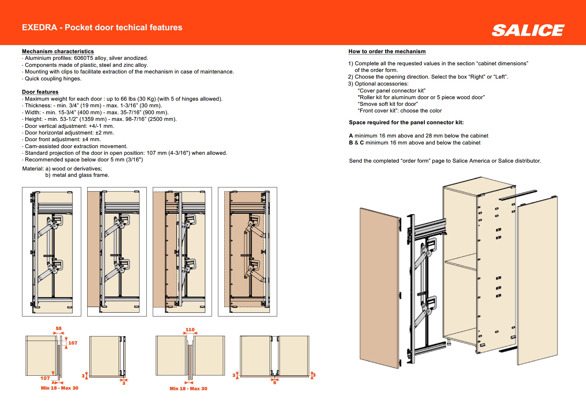

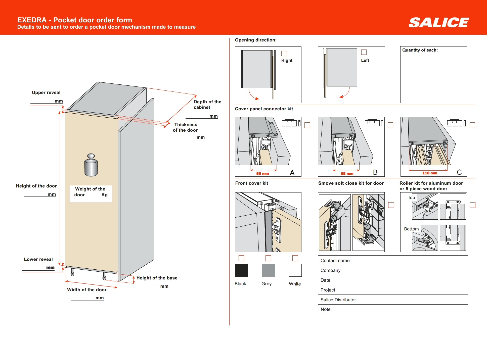

The Salice Excedra Pocket Door system is ideal for this application. Here is a snapshot of the Excedra. Please let me know if you are interested in more details and pricing. Excedra is available through any Salice distributor.

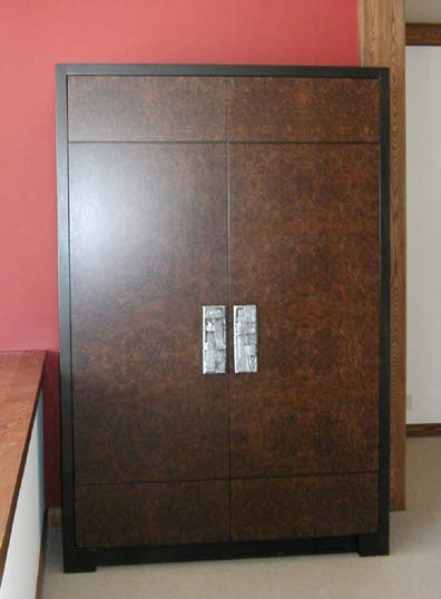

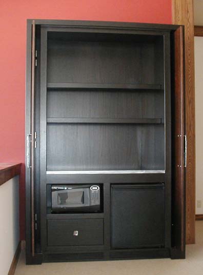

I've never used the Hafele or Salice products, so I can't comment on those. I have used the Accuride and KV pocket door products dozens of times the last 20 years, so I do have do have some insight on those. The Accuride 1332 works well, and is pretty easy to install. You might be exceeding it's limits with the height of the doors for your project. The KV rack & pinion slides also work well, but they take more time to assemble and install. Maybe an an hour and a half per door by the time you're done with the final adjustments. They would work better for the door sizes you're working with. The rollers you're concerned with are on the back side of the doors for both types, although you could mount additional rollers if you felt the need to assist alignment during retraction.
I built the the piece shown in the photos 12 years ago. African mahogany case with walnut burl veneer doors. We just moved it to a new house last month. The KV hardware still works well, and no wear on the doors.

I would agree the instructions can be intimidating if unfamiliar and it is a first install.
Before Salice accepts an order, we ask the customer to complete the questionnaire below to ensure their application is suitable for Excedra and that we customize the hardware correctly to the customer’s needs. Customization means that we supply the unit pre-cut to the customers' depth dimension.
If our technicians see anything that may be inconsistent with the system, the customer will be contacted to discuss the details before any product is shipped. The mechanism is completely assembled, and a drilling scheme is provided showing the location of all hardware on the cabinet side.
The unit is custom crated and shipped directly to the customer. Lead time is approximately ten days.
Our technicians are available any time during business hours to answer any questions.
Here too is a video of the operation.
Thank you,
Dennis
View higher quality, full size image (1937 X 1357)
Salice Excedra Pocket Door Video

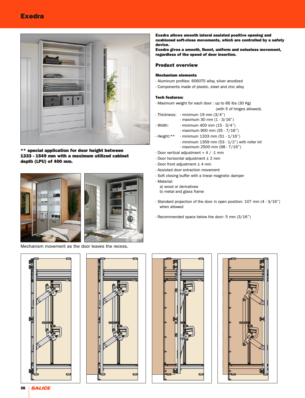

Here is some additional information. I hope this is helpful.
Dennis
View higher quality, full size image (1941 X 1373)
