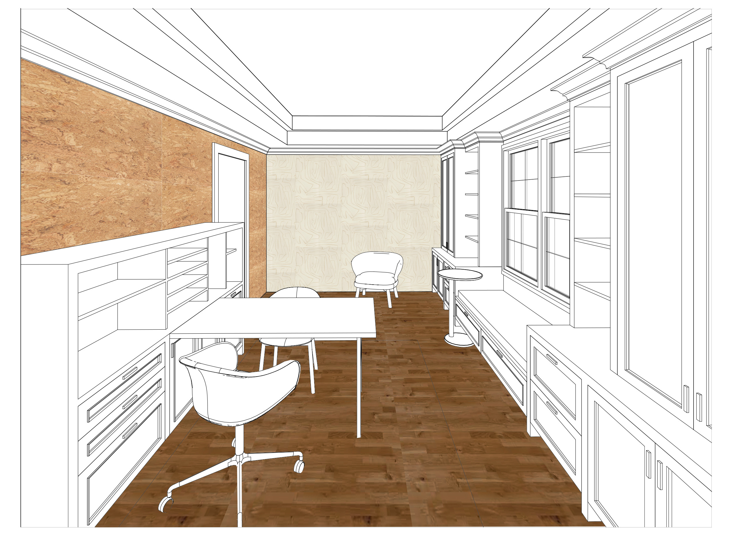

I'm trying to determine some good options to attach a removable solid wood desk top to neighboring cabinets. it will be a well used surface, and likely rarely removed, but does need to have that functionality. my concerns are that the desk feel stable and not wobbly, so maybe it needs to lock in somehow with mechanical fasteners, rather than simply sit on dowels or dominos? inspiration photo and drawing included for reference (hope it uploads properly). thanks in advance.
View higher quality, full size image (563 X 737)
View higher quality, full size image (2528 X 1876)

Maybe a table leaf latch similar to this?
House of Antique Hardware
8/26/20       #4: attaching removable desk to cabinet ...
Pretty much depends on what you want the shelving unit to look like when the desk is taken off. Maybe you have an insert that is installed when the desk is gone, but covers up the hardware. If I used the insert I would use loose tenons and either a table leaf latch or two sash locks.
8/26/20       #5: attaching removable desk to cabinet ...
What will the owner do with the desk when pulled out of the way? It might be more useful to have four legs on the desk for the added flexibility
8/27/20       #6: attaching removable desk to cabinet ...
If you build it so it sticks into the cabinet a couple inches. Kinda like a tight fitting drawer. It could be as simple as a solid hardwood stretcher that the door shuts upon. It needs to support the weight of the table. The cabinet stretcher is above the desk top to keep it from pitching. You could use a couple of decorative knobs inside the cabinet going up thru the structural stretcher. They would keep the desk top in place.
8/28/20       #7: attaching removable desk to cabinet ...
Chris H.
Website: https://www.csaw.com/lamello/p-system/
Perhaps the Lamello Clamex connectors in conjunction with Dominos would be a good option for you? See the video link of one of our customers doing something sort of similar. They make a permanent connection in the video, but the Clamex mechanical connectors may be used over and over - just don't glue the joint obviously if you need it to be removable. Please reach out if you have any questions.
Chris
Video
