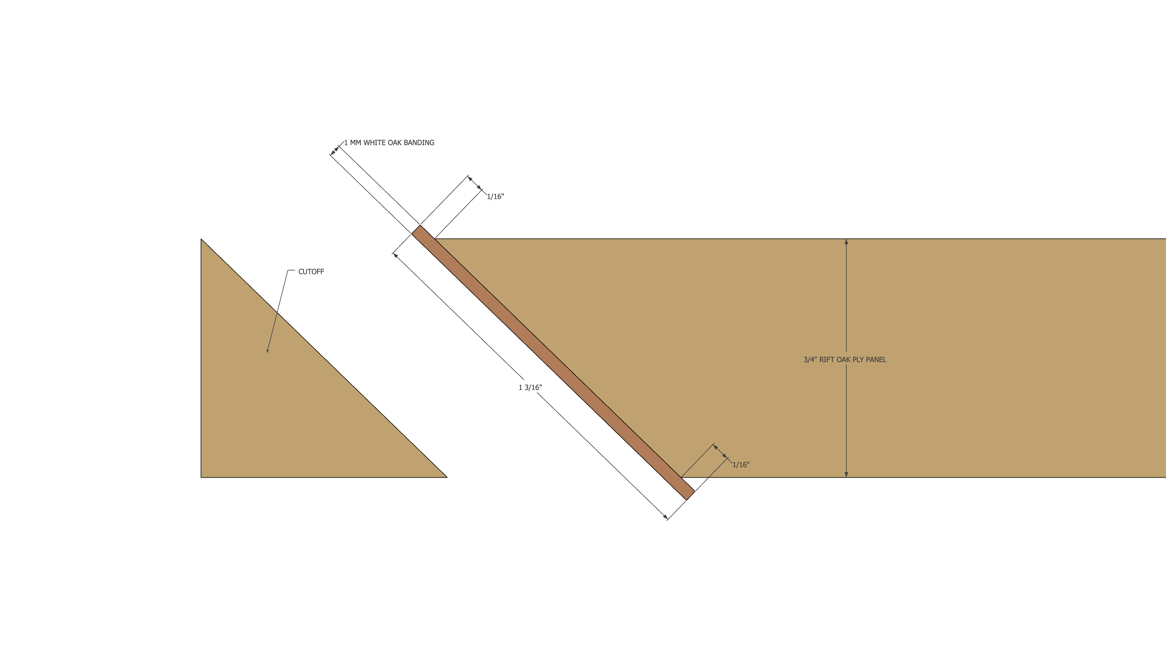

This keeps coming up. Paint grade is no problem but stain grade is. Id like the process to have consistent results whether an 80" tall door edge or a 10" drawer front. Also, we are sequence matching (Rift White Oak...again)
In the past, we have:
Opt 1 cut out MDF, then wrapped MDF (glue/clamp) in solid wood and then veneered both sides, trim to size and back bevel finger panel for pull. Super large pain in the...
Option 2: cut out veneered panel, back cut, glue on a THICK strip of Oak, flush trim, back bevel
Option 3:cut out veneered panel, back cut, brush Titebond on bevel of panel and back of 1MM veneer, let glue skin over , iron on and flush trim.
All of it is labor intensive with the option 3 being the least and what I am leaning towards.
How do the big shops do it?

Not trying to be rude, but why do you care about labour?
Do you want the option that is going to be the least amount of labour or the option that is going to be the most durable?
Let your customer dictate what they want. Option 1 is the most durable and also the most labour. It will cost you $$$
Option 2 is in the middle it will cost you $$
Option 3 is the least labour and probably the least durable, it will cost you $
It is like drawer boxes, a tongue and groove solid box with a Blum slide is $$$
A Baltic birch drawer box tongue and groove is a little less, a melamine box is less again. Let the customer pick to meet their budget.
Regardless of which option you sell your labour should be covered , if you are selling something for less than it cost you to build you are losing money.
The big shops are building it the same way you are, basically the only other option to what you mentioned is solid wood with a bevel.
What do you do for regular handles on a cabinet, do you charge the same price for all of them or do you have different levels of pricing?
