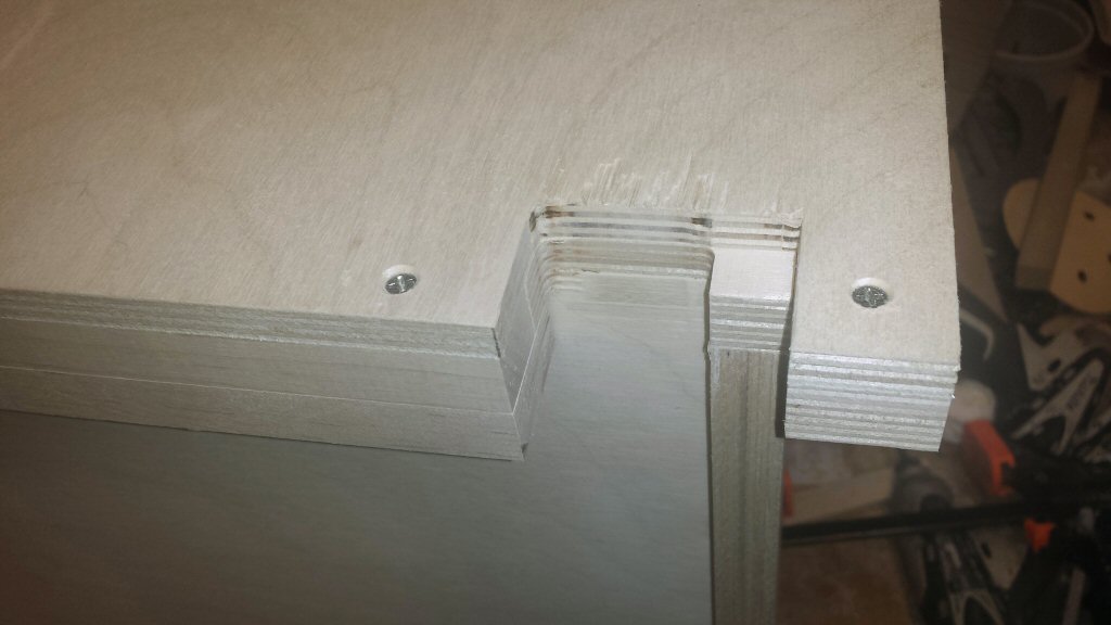

We are looking for a better way to notch for soft close undermounts. Presently we use a sabre saw and notch the part before assembly of drawer Was wondering if anyone uses a router table with a fence and stop to do this or what other methods are out there?

For non dovetail boxes, just make your whole back short. No need for notches. For dovetail boxes, I use a handheld router with a template and guide bushing.
9/9/20       #3: notching for soft close undermounts ...
I made a router jig for notching. I use two routers to make the notch. A 7/8" flush cut to remove most of the meat and then a 1/4" flush bit to "square" off the notch.
I make my notch about 1/16" wider than a square cornered notch to make sure the 1/8" radius doesn't interfere.

We use a stacked dado blade in a table saw. Fast and simple. Leaves an acceptable finish in solid wood boxes.

I use to use the tablesaw with a fine blade and push the drawer back and forth over the blade while advancing it to cut the notch. Gave acceptable results. Had to adjust for the height of the bottom. The bottom of the slot was at .5" but the bottom wasn't always as thick as the slot and you had to adjust.
With the router it flushes automatically. I find it pretty quick to do also. I saw a hole and notcher work and it was a pretty neat machine. Expensive. If you made drawers for a living it would be worth it. If you made them for the cabinets you make it wouldn't be worth it I don't think.

I use a router table sled and a 1-1/4" bit.

Cheap Rockwell shaper I bought on an auction.
Slowed it down to a reasonable spindle rpm with a pulley off McMaster.
Had somebody punch a 8" dado set for the 1" spindle.
Made a tall(ish) fence for it since no fence or hood came with my $200 shaper.
It's not terrific, but it beats doing it in a tablesaw with a dado head in two passes.
Ideally you do it with a tall notcher that drills the hole in one operation. Cantek has one that I think I'll be getting one day. Circle K manufacturing has one, as does Penske. The Penske looks nice.

I leave the backs short, do you all feel the box is stronger or the slide is somehow more secure even though it may not touch the notch ? Why notch ?

I use the bandsaw. I set the fence to the width of the notch & first make that crosscut. I cut to the bottom of the drawer bottom dado, then use a spacer to make the rip cut.
I fit the drawer on the tracks & push in to mark where to drill holes.
