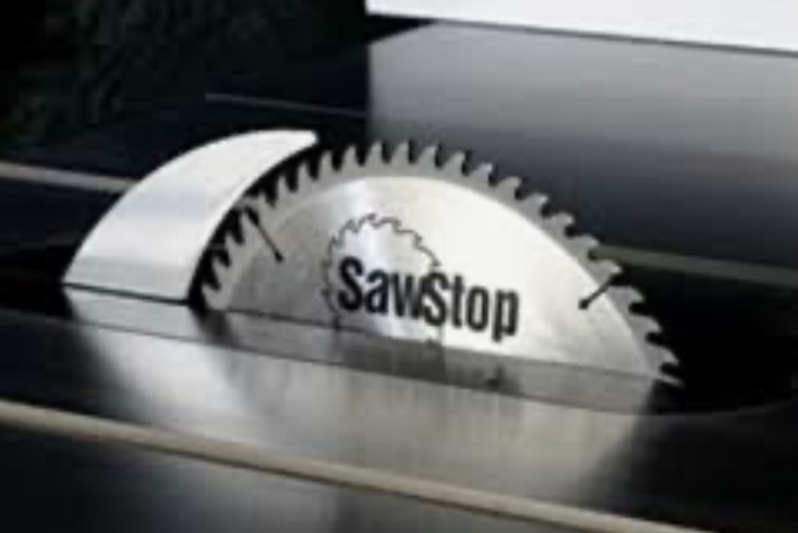

You must be an owner, and not a shop guy. What he removed was a splitter/anti kickback mechanism and a plastic guard that can also work as a dust and chip collector.
A riving knife looks like a shark fin you see in the movies, it is directly behind the blade and it is slightly lower than the blade so the operation he was doing is not a problem.
