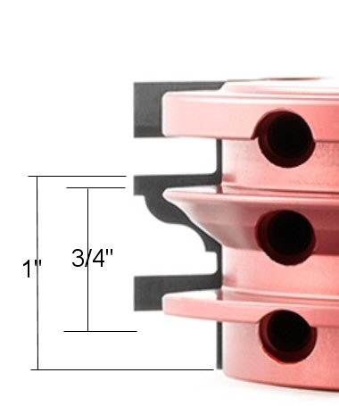

Anyone use the Amana 61272 with 3/4" door stock? The description states for 7/8 to 1" doors and the provided measured drawing does not give enough info.
Open to alternatives, but i like this price point ant the option for 4 profiles.
https://www.amanatool.com/61272-insert-carbide-2-wing-stile-rail-4-3-4-dia-x-1-1-2-x-1-1-4-bore-profile-1-steel.html

The photo on the right is the one I am referring to.
With the same head you can buy as many shapes of steel backers as you want.
You can make more than door profiles
It’s worth a look.
Good luck.
Great Lakes universal insert.

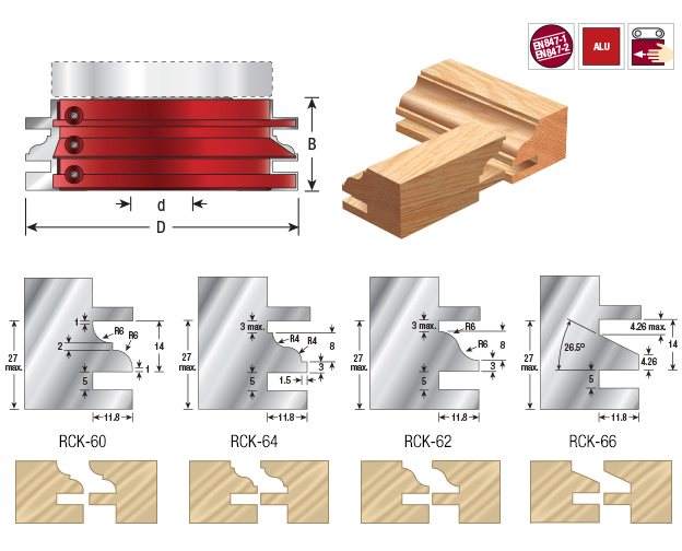

Took the picture into my photo editor and it said the cutter height was 1 1/2". So I set it at that on my screen and took direct measurements. I'll be pretty close.

thanks! didn't think of that. seems like from that this cutter is just a bit too big to reasonably do what i need. increasingly i wish tool companies would provide .dxf downloads of their stock profiles.

The dimensions are right there (in metric) on the product page.
