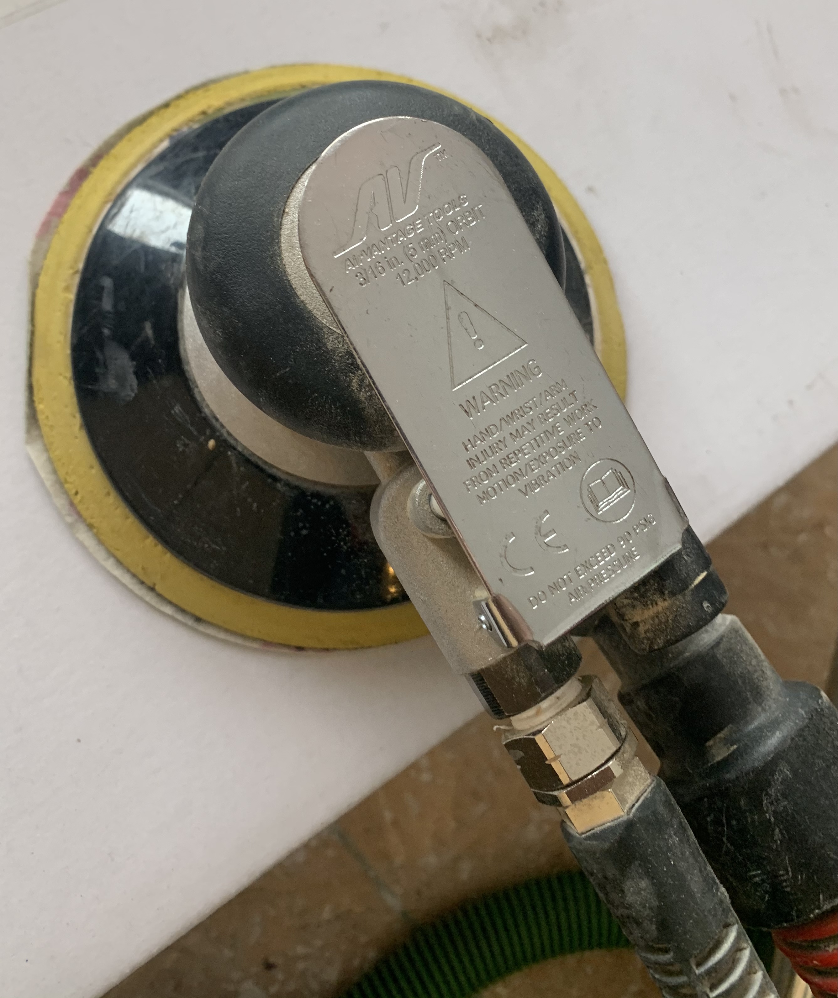

I took a picture of the sanders I use, maybe I will save $700 and not buy anything new. I was ready to buy the ETS 150/3, but not sure now.

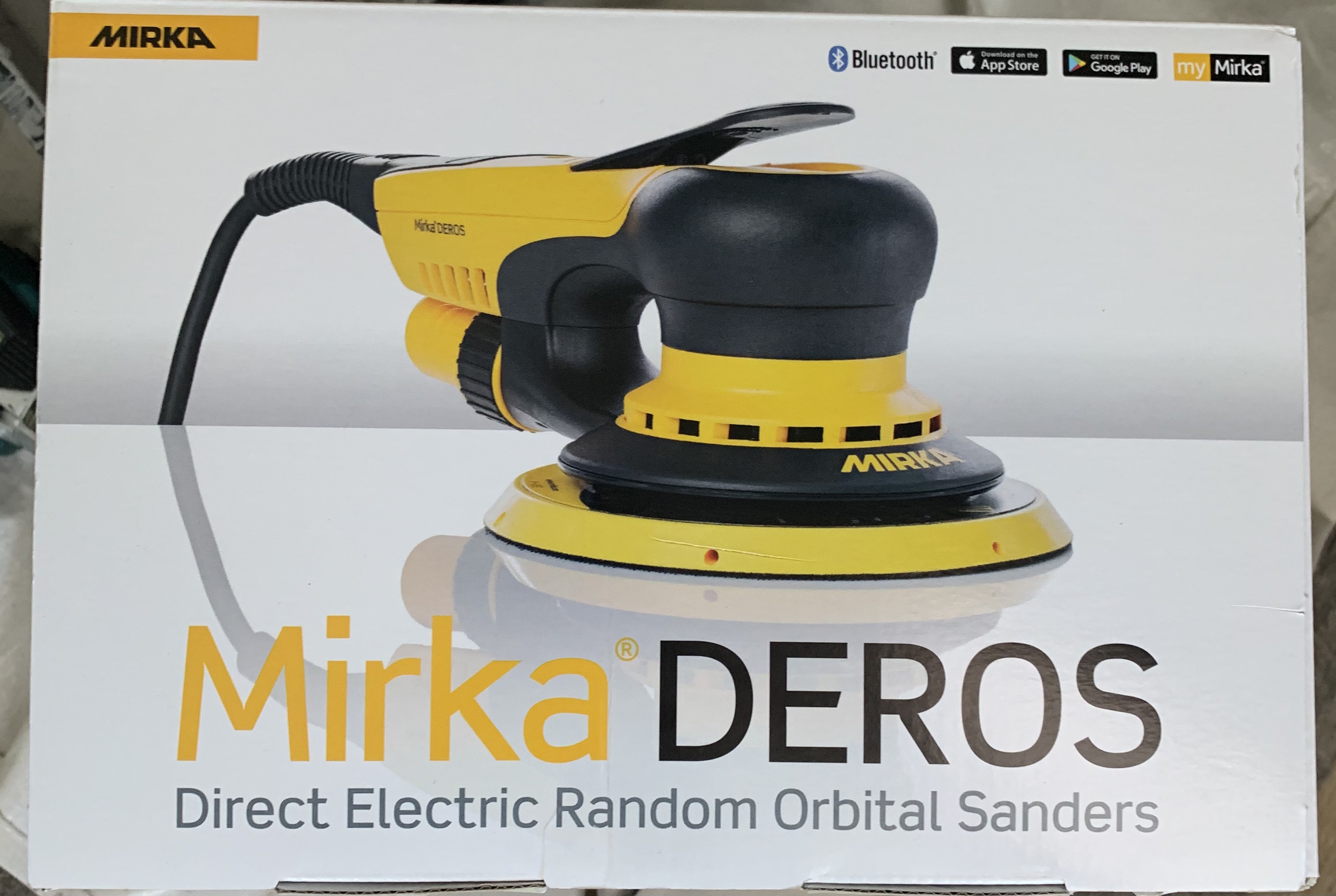

Thanks for all the input in this forum, the sander finally arrived and I will now give it a whirl. The hose still hasn’t come, but the festool hose fits nicely so all good.
View higher quality, full size image (3024 X 2029)
