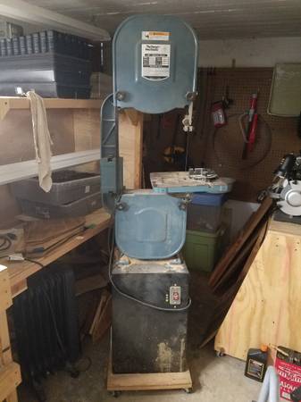

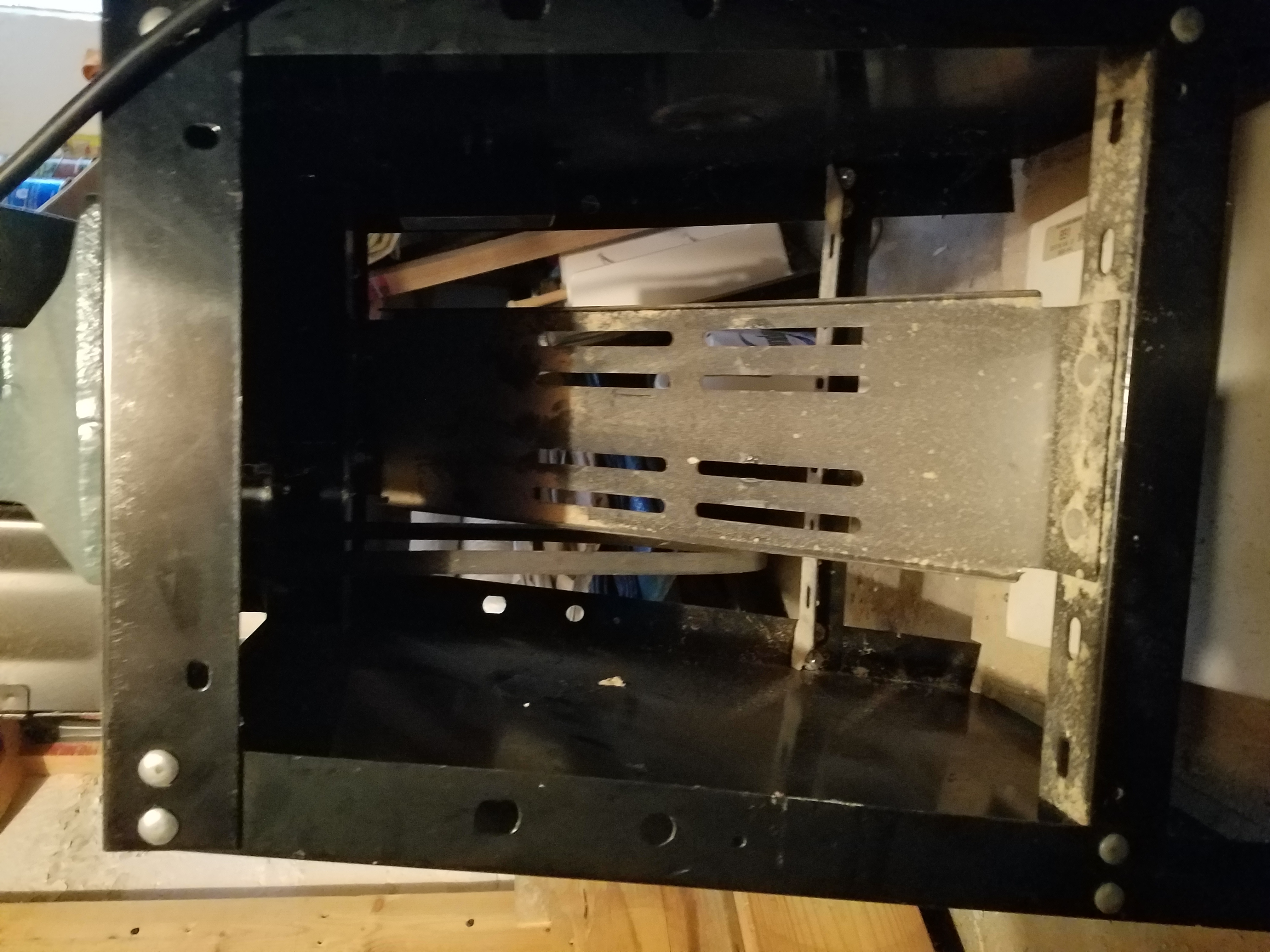

Looking for my first band saw on the cheap and I found a 14" Reliant on sale for $50 but the seller says it needs a 1 HP motor. If I can find a used motor for around $50 then I'd go for it but I have no idea what size/type pulley the motor would need, and I'm guessing the seller doesn't either. I know the Reliant brand is akin to something like Harbor Freight so I know it's not worth much trouble, but the wallet is a bit slim at the moment.
I suppose I could find the right HP motor at the local electric repair shop but does anyone have advice on what size/type pulley I should look for to go with this saw?
PS. I know the general advice is gonna be to skip this one altogether and look for something better, but there's just no other way I'm gonna find this cutting height (which I need) at the ~$100 price range.

Buying a pulley will be very inexpensive, you just have to match the pulley size and pitch that is on the bandsaw. The other thing is you have to buy a pulley with the same shaft diameter as the motor you buy.
I am not sure where you are located, but places like Harbour Freight, Princess Auto, Busy Bee, etc carry Pulleys for cheap. Where is the motor that came with the bandsaw, even if the motor is shot it should still have he pulley on it, maybe it could also be repaired?

Ahh, the hope and promise of an affordable first bandsaw. In the early 80's, I pulled a similar saw out of a scrapheap; the saw was one of the "elephant" saws, so-called because of the elephant stamped on the plastic knobs that held the blade covers on. These were knock-offs of the Delta/Rockwell 14" band saw; one manufacturer, many different brand names.
The table trunnions were broken, and the previous owner "glued" the table in place with some construction adhesive. After cleaning it up, I ordered the Delta trunnions, and they fit perfectly, right down to the hole pattern. Delta may be a possible source for parts other than the motor pulley.
In addition to what has already been said, you might pull both blade covers off and see if you can get a straightedge to touch both rims of both wheels, or if it can be adjusted to do so, which would mean that you may actually be able to track a blade on the saw once you get it running. Make sure that any adjustment screws or knobs actually do something.
It looks like a workable 14" saw with a riser block, allowing a 12" cut under the guides. Finding out the blade speed on a 14" Delta saw will give you a good approximation to determine what the motor pulley size is that you need. Harbor Freight, Graingers, Northern Tool, McMaster-Carr and Ebay also come to mind as sources for the motor pulley.
Don't lose sight of the fact that a new band saw, of similar quality but without the riser block, is about $400.
