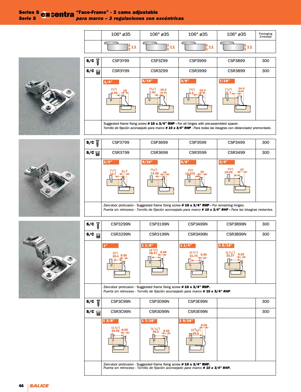

I'm trying to find some hinges for some pretty close to a 1/4 inch overly, 7/16. How much adjustment do you imagine there is on this type of hinge. These would be screw-in face frame mounted. I'm most familiar with 1/2 inch overlay compact hidden or two-part hinges which have about 1/4 inch of play.

The width of the doors is 7/16ths greater than the width of the opening.

Thicker plate on a 1/2" overlay hinge? 6mm plate would likely work

Butch,
The Salice Series S face frame hinge is available with 1/4", 5/16", 3/8" and 7/16" and greater overlays. They adjust 1/16" outward and 1/8" inward.
Also, as Mark mentioned, you can use a two piece hinge an plate combination. In this case you would use a "half" overlay hinge with a 4mm mounting plate.
C2P6G99 Half overlay, self close, screw-on
BAU3R49 4mm face frame mounting plate.
If you are looking for soft close the part numbers would be different but the hinge and plate the same design.
Here is a page from our catalog showing the Series S options. Also, here is a link to our web site for additional details.
Best of Luck
Dennis
Salice America
View higher quality, full size image (1046 X 1358)
Salice Face Frame Hinges
