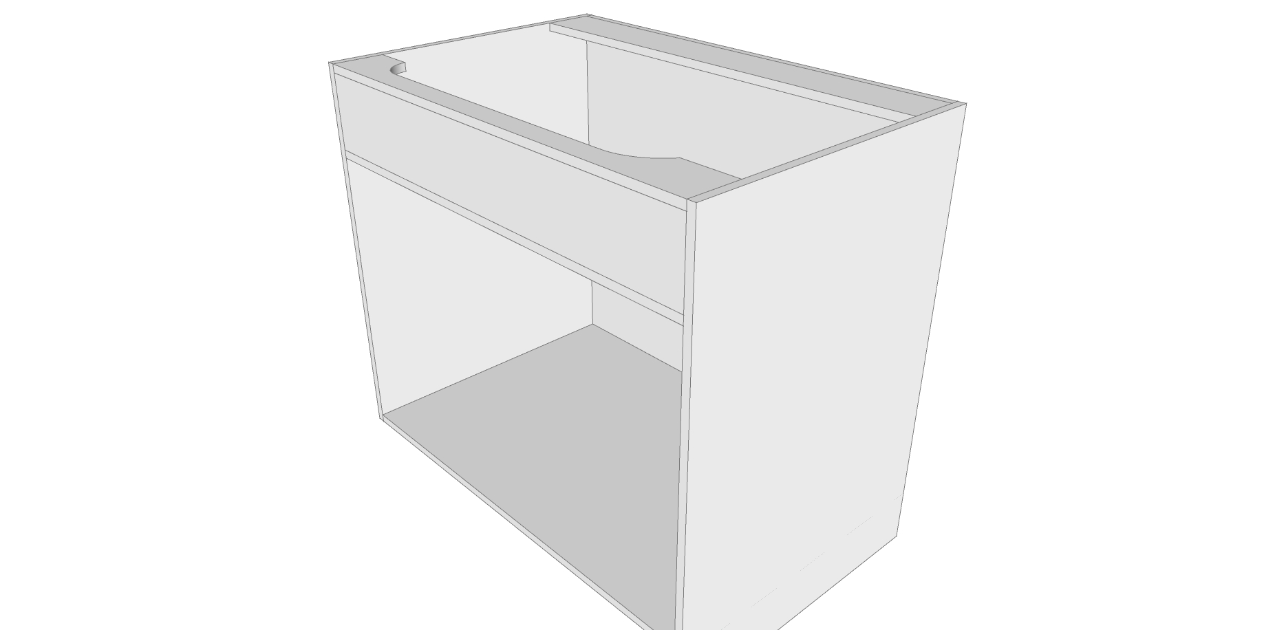

A frameless sinkbase gets its left, right, and deck front edge taped. But the front stile, the stretcher piece behind the false drawerfront, what are you doing to get tape-matching texture at the top and bottom edges, where one can see the front over and under the false drawerfront?

OK and thanks for the responses. I think I've developed a nice solution. See the images.
This is CNC-cut carcase parts, and the parts joinery is "lock tenon" meaning spaced-apart mortise and tenon with zip-screws in the gaps.
The front stretcher part will be edgebanded in the CNC shop on its bottom edge. In the field, using double-sided tape, edgetape will be applied to the top and bottom edges of the front face.
The tape is 0.5 mm thick, and the front stretcher will be positioned such that the edgetape and mounting tape thickness defines the offset, and the result is the edgetape (carcase sides and applied to front) all flushes out.
View higher quality, full size image (912 X 875)
View higher quality, full size image (820 X 669)

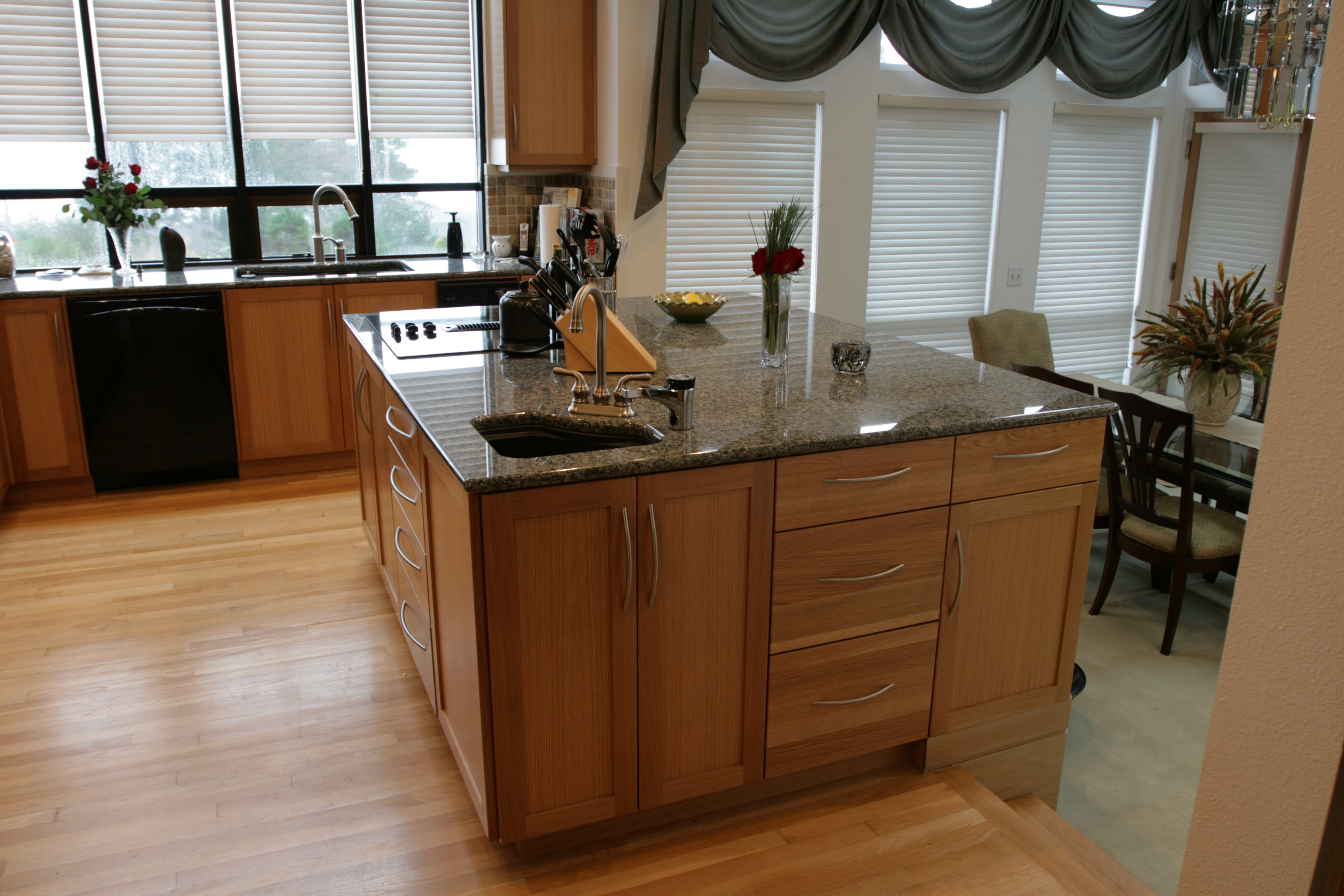

"Full height doors don't seem right, they expose all that sink and plumbing when opened,
Gene, you don't see the plumbing or sink. I have the same spreader you do only it's behind the door and it's made of the finish material. (wouldn't have to be but I like it that way) As for the "look of the drawer front line" There are many full height doors in what I build and find this easier. A false drawer front is left over from face frame days. To each his own.
View higher quality, full size image (3504 X 2336)
