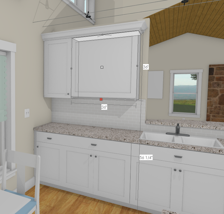

Sorry, should have qualified the question.
Frameless, CNC-cut.
The finished end visible here on the wall run adjacent the sink is what I refer to. Not an applied end, but the end that's the left side of the carcase.

9/10/21       #5: Preferred way of fastening finished ...
Nathan Wesseling Member
How would you assemble a unfinished end here? What's the finish on it?

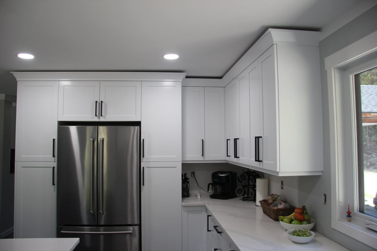

I would do an upper end like that one of two ways: applied end panel in the field (36" high by cabinet depth + door projection + scribe... often 14.25" or so) or I would make/finish the end gable of the upper in the shop before assembly, and would have an integral scribe on the cabinet gable. During cab assembly I would biscuit the deck and any mid shelves/stretchers, and pocket-hole the top on. The biscuits carry the vertical load of the shelves/deck. I've never had a failure in the field that I know of.
Without a doubt it's easier to field apply a finished end panel, but it also uses more materials. Alternatively, the integral finished end takes longer, but uses less material and IMO looks WAY better/cleaner. I am a super small show though for what it's worth. Picture shows example of an integral finished gable.
