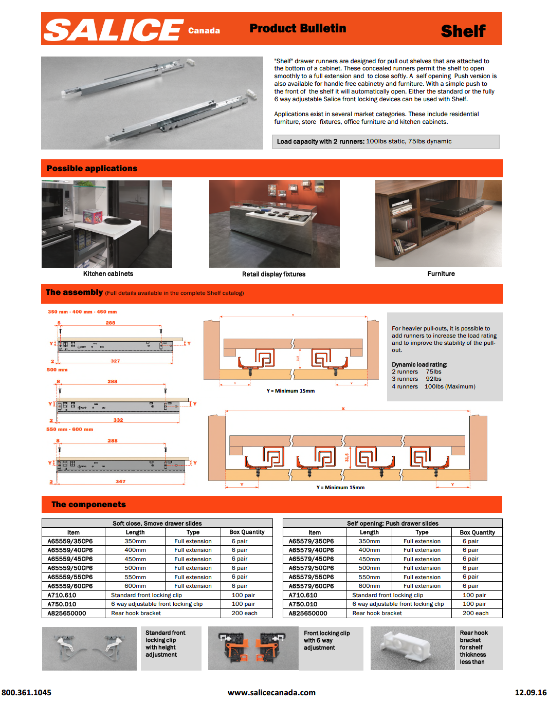

Are there true bottom mount slides for drawers where mounting to the side of the cabinet is not viable? I have an installation where I need to install 2 trays side by side in one cabinet bay and so there is nowhere to mount the slides on the inside edge of each tray. Are center mounts the only option or are there sets of bottom mounts slides that would mount to the deck of the cabinet and the bottom of the tray? Thanks.

David,
The Salice drawer slide called "Shelf" is designed for exactly what you describe.
Shelf is available from any Salice distributor in either soft close or push to open. It is available in all common sizes.
For very wide pullouts, extra slides can be added.
Here is a product bulletin detailing this, with part numbers, and a link to the "Shelf" slide on our web site.
Best of luck
Dennis Beam
Salice America
View higher quality, full size image (1066 X 1370)
Salice Shelf drawer slide

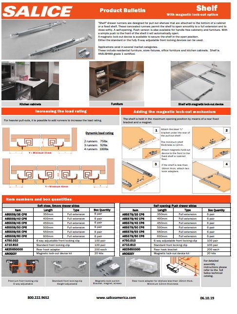

oops!
I meant to post this product bulletin. It is a newer version detailing an optional lock-out devise. This keeps the shelf from drifting back into the cabinet if it were used for a keyboard shelf, for example
Dennis
View higher quality, full size image (486 X 642)
