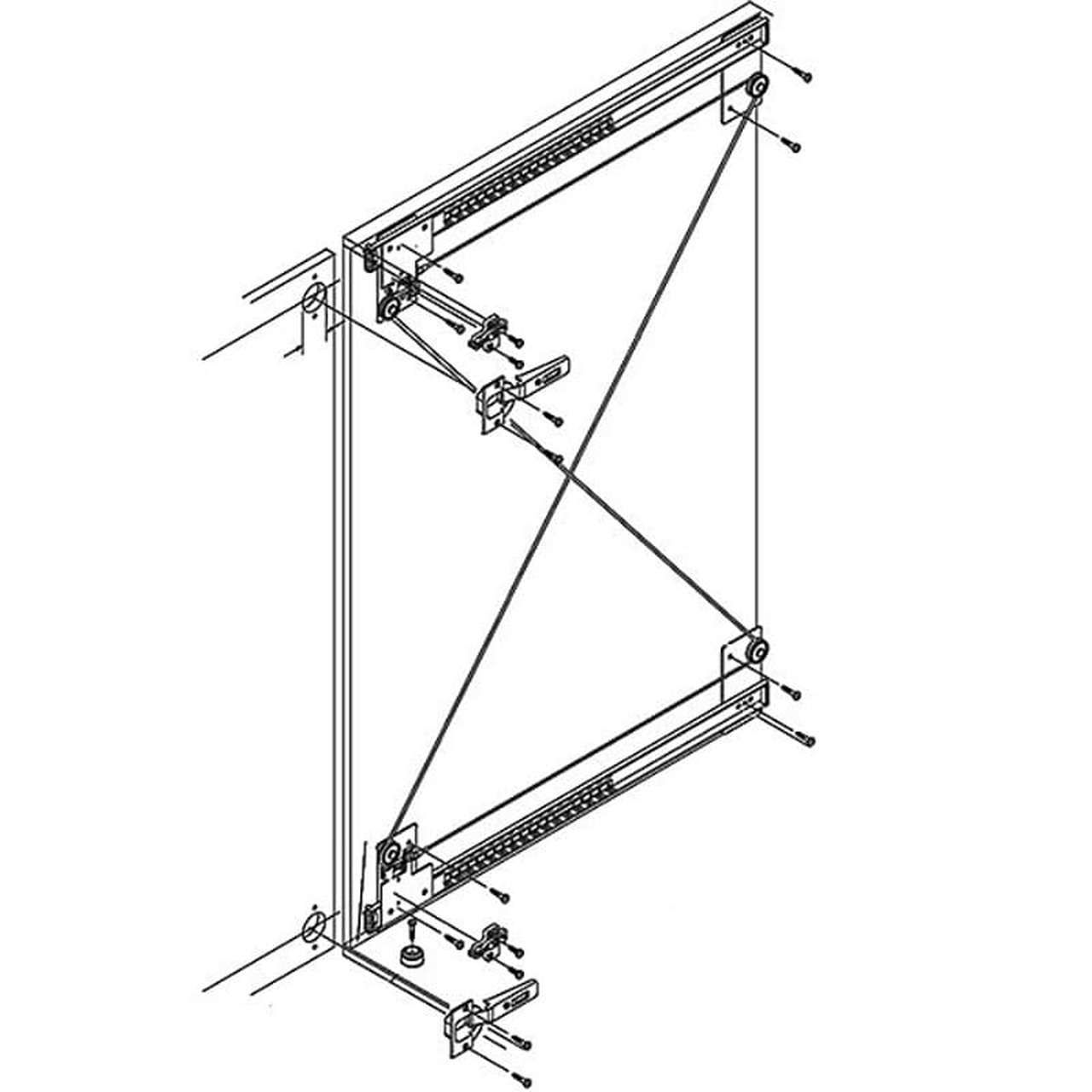

Scott Markwood
Website: http://www.hafele.com/us
Allow me to suggest the Hafele XL pocket door system. It's a 2 hinge system, so it's not for massive doors, but up to 60" tall and up to 35lbs it's a nice solution. I've always found it easy to install and adjust and nothing rubs against the door.
I just looked it up on our website and have learned that we have changed the name for the complicated "XL Pocket Door System" to the much more intuitive "Slido F-Park 71 16A". Ask for it by name. :-)
View higher quality, full size image (1280 X 1280)
Häfele Slido F-Park 71 16 (Was "XL")
