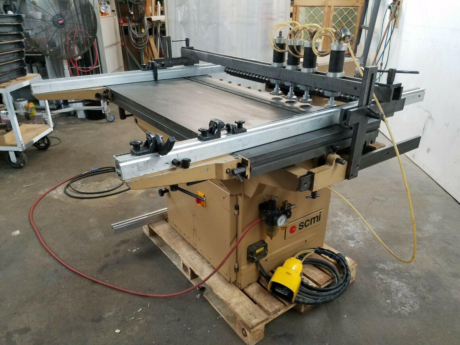

looking at a construction boring machine for sale anyone know if you can do unlimited length's like let's say i wanted to drill a bookcase end, never used one of these machine i know the are used for boring for dowel's in framless cabinets. any thought apperciated.

Is there any provision for a line boring fence? Perhaps contact SCMI?

most machines of these machines can do any length and just by looking at it this one can also. construction and line boring

I had this same machine years ago. FM 35 I believe. It was good for construction drilling in ends and faces of dowel holes in case work. Mine had extension fences for longer work. It could do line boring but was pretty unhandy for this compared to the Ayen machines. Line boring of panels longer than what fit between the fences was challenging and time consuming to set up.

It looks like the hold down bar supports could be reconfigured - so that the uprights are at the back of the machine - to allow for line boring long material.
You would need to add a longer back fence with accurately spaced stops. With 35 spindles, two stops 1120mm apart would give you an ~87" row of holes.

Correct, the clamps could be moved and the fence could also be be run the other direction and the 2 fences connected together. Drilling line holes involved moving fences and clamps a lot. It was a very robust machine, solid cast iron construction.

I have this machine and we use it for confirmat drilling on our end pieces. Tried line boring before cnc and I agree with Joe that it was a lot of set up time. Prior to cnc I had a ritter 23 spindle line bore machine that worked fine. The 35 is a solid machine and has kept its tolerances.
