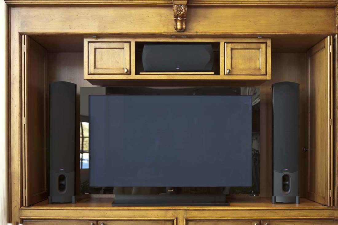

I've done this a lot with non mortise hinges for bi-folding pocket doors for TV cabinets. I mount them on the back sides of the doors with a 1/16" reveal between them. The doors will fold back completely with only the barrel showing.
