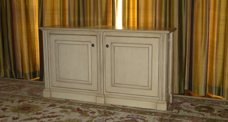

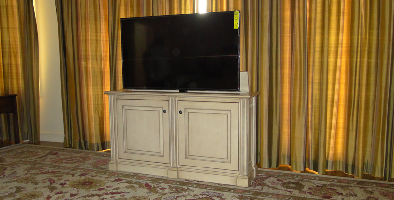

duster
Lots of options out there for electrically operated, remote controlled tv lifts. I've done quite a few tv cabinets with lifts, mostly using Nexus brand hardware. They come in wide variety of styles and functions. They're american made, not cheap, most of the ones I've used are in the $1000 - $1500 range. Never had a call back in the 20 years I've used them. There are also a lot of chinese knock offs available now for 1/3 the price. Amazon carries quite a few of those. Reliability can be questionable with those, according to the reviews I've read.
Of course, whatever hardware you use, don't build the cabinet until you have the hardware and have a good understanding of how it interfaces with the tv you have and cabinet you want to build.
