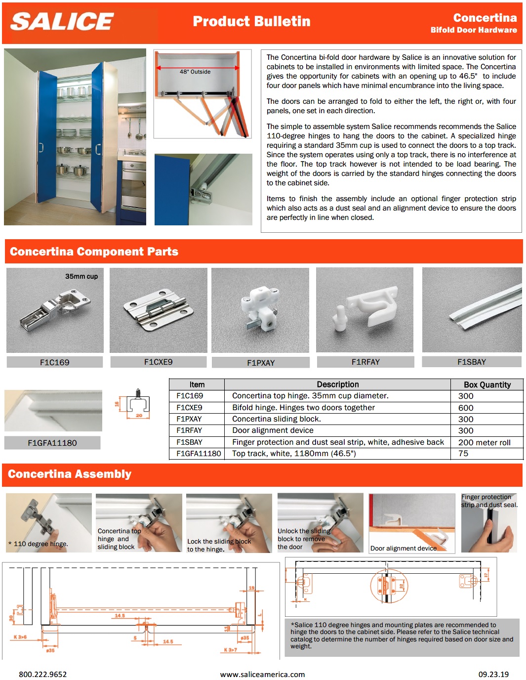

I recently did a stack washer/dryer and used Concertina
Doors were 16x94 using multiple Salice hinges, Concertina top track and guide and strike side bottom alignment guide
No problems at all
2/2/22       #3: Large cabinet bifold door hardware ...
Hello Great Scott,
Jim is correct. The Salice Concertina bifold door hardware would be ideal. The 44" height is no problem and it does not require any bottom mounting. It is an easy install.
Below is a product bulletin for a quick overview.
For two sets of 2 doors (4 panels total) you would need:
1 Top Track - can be cut to match your opening width
2 Sliding blocks
2 Concertina top hinges
6 Bifold hinges to hinge the 2 doors together
6 Standard 110 degree hinges and mounting plates
2 Optional dust seal for between the 2 doors
I have also included a link to our web site where you can see the complete details.
Regards,
Dennis Bean
Salice America
Side note: What is "Concertina"? The Concertina is the Italian word for the musical instrument, the accordion. Hence, it is used here to describe the folding and unfolding action of the doors.
View higher quality, full size image (1065 X 1376)
Salice Concertina Door Hardware
