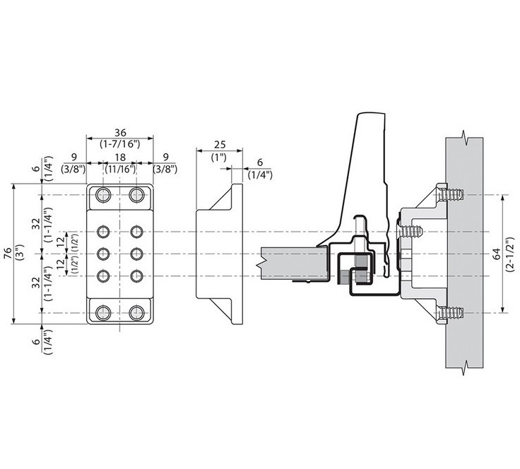

Tandem with Blumotion slides. These will have trays nominally 27" wide x 24" deep.
We are inclined to use the Blum spacer shown below. Three per side. Sound OK?

Chris
Before switching to wood blocking for aesthetic reasons we would use these all the time. 2 blocks per slide on 550’s (22”)

Ed Austin
If you are using overlay doors , then you might consider using zero protrusion hinges and no spacers.

Bruce H
We use 19mm Blum spacers on each side. Keeps the cabinet clean and simple and every cabinet is the same. I step the ROS back an extra 10mm because my door hings might close over the shelf.

Bruce H
We use 19mm Blum spacers on each side. Keeps the cabinet clean and simple and every cabinet is the same. I step the ROS back an extra 10mm because my door hings might close over the shelf. Also use three per side.

Rich
We used to use those or similar standoffs but about 2 years ago switched to Rev a shelf adjustable pilaster system. Using that system avoids all the questions and vacillating of where the shelves get mounted, etc. They cost about $40 per set, you would need 2 sets with 4 shelves. Clients love how easy it is to adjust them later

Daniel
I like that adjustable system that Rich mentioned. It costs ain’t more but it’s simple and easy to work with. And easy the move up and down later
