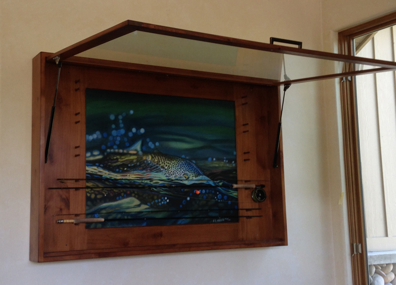

duster
I've done a few pieces with lift up doors supported by gas struts. I've found them at auto part stores and Amazon.
The struts come in a wide variety of load capacity, and it's a bit tricky to get the correct ones for a particular application. Where you mount the strut on the door and the cabinet sides can make a big difference in how well the struts support the door.
I'd suggest doing a mock up with some scrap to verify that you have the correct strut and mounting points. It took me a few tries to get the correct strut and get the door working properly on the fly rod case shown.
