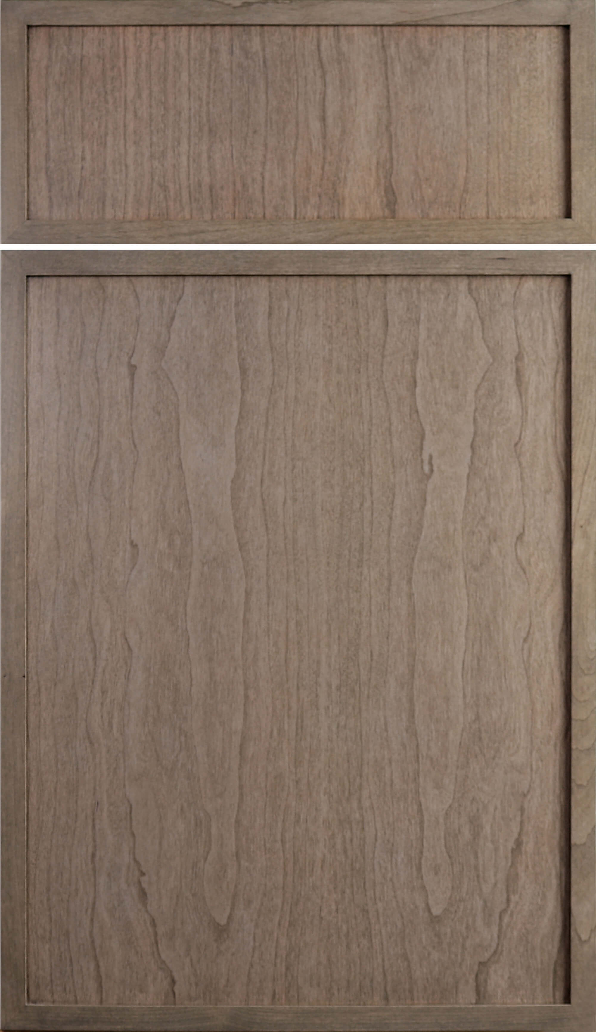

Applied moulding on the inside of the door frame was always a pain to install by hand. But the new trend of doors seems to have a thin profile molding on the outside instead. Anyone know of a good method for gluing these doors together?
The big difference is that larger doors would require clamping along the entire perimeter to keep the thinner molding in contact with the center panel.

Could use pinch clamps. The ones with soft tips.
3/17/22       #3: Clamping slab doors with outside ap ...
What about a band clamp around the perimeter?
3/18/22       #4: Clamping slab doors with outside ap ...
Tom Gafgen
I once had a situation where I needed a ton of pinch clamps and made them quick and cheap by cutting a slot down the length of a 3" pvc pipe and then cross cut them into pinching C clamps .
You can adjust the pinching pressure by how wide you cross cut the pipe .
