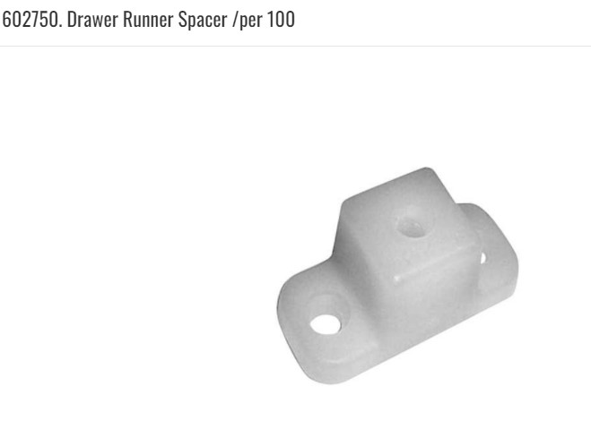

The 3/4" spacer fixes to gables with 5mm x 14.5mm system screws.
Pic attached. I cannot find this in Blum's current catalog, but am able to buy them. Need dimensions for programming the CNC-cut cabinet parts.
What is center to center spread for the mounting holes? Looks like 32mm but is it?
Is it 3/4" (19mm) thick?
View higher quality, full size image (659 X 480)

Yes, 19 and 32mm

I think this is the one
https://www.richelieu.com/documents/docsPr/60/27/50/12/60275012/1116794_hd.jpg
