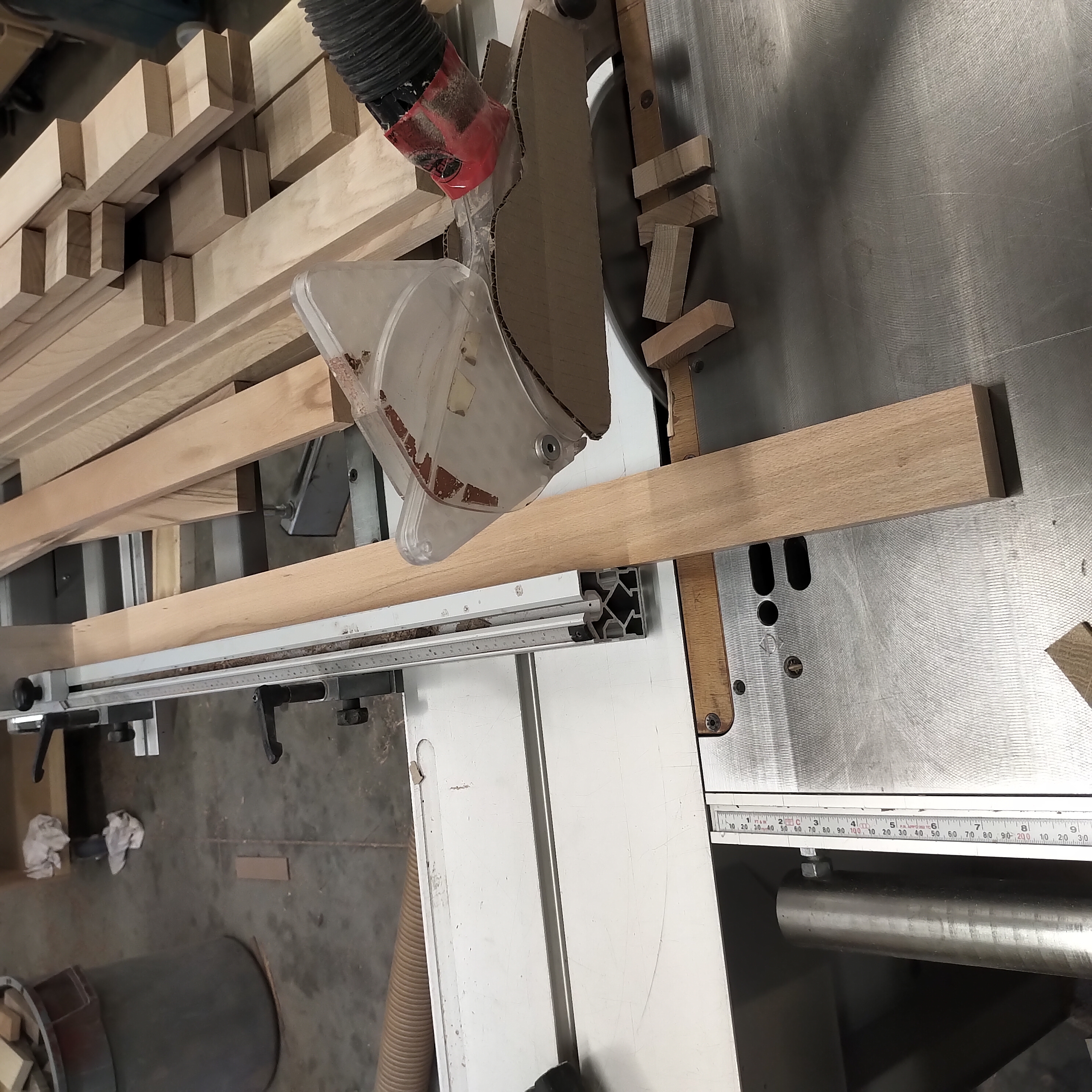

Here is another example of cross cutting solids. Note cross cut fence orientation

Mark B, the crosscut fence was placed that way in my pic for solids, typically it is up at the front of the out rigger for panels.

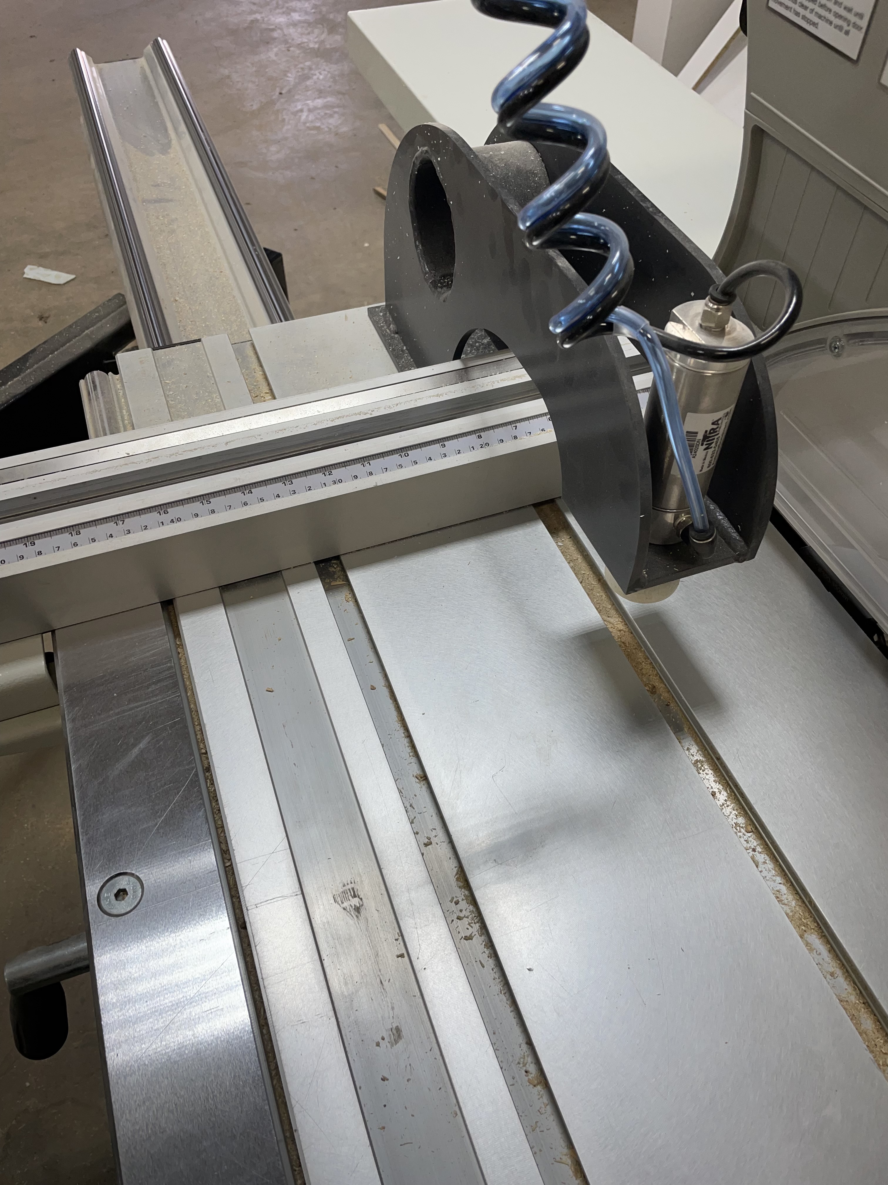

I basically do why Thomas said and Dave. Once you get a system it works great. I’ve cut tons of 4 by 8s and occasionally 5 by 9s. Those require an second guy to handle. But another thing I’ll mention that I think is one of the most important things on a slider is a hold down of some type. Make things much easier and. A much nicer cut

Daniel that's a great idea. I like that setup. We use our slider for ripping tons of hardwood to size and we have a 12" Royce ripping blade on the saw. At the front of the slider table we have a pinch wedge but that air hold down would work great.

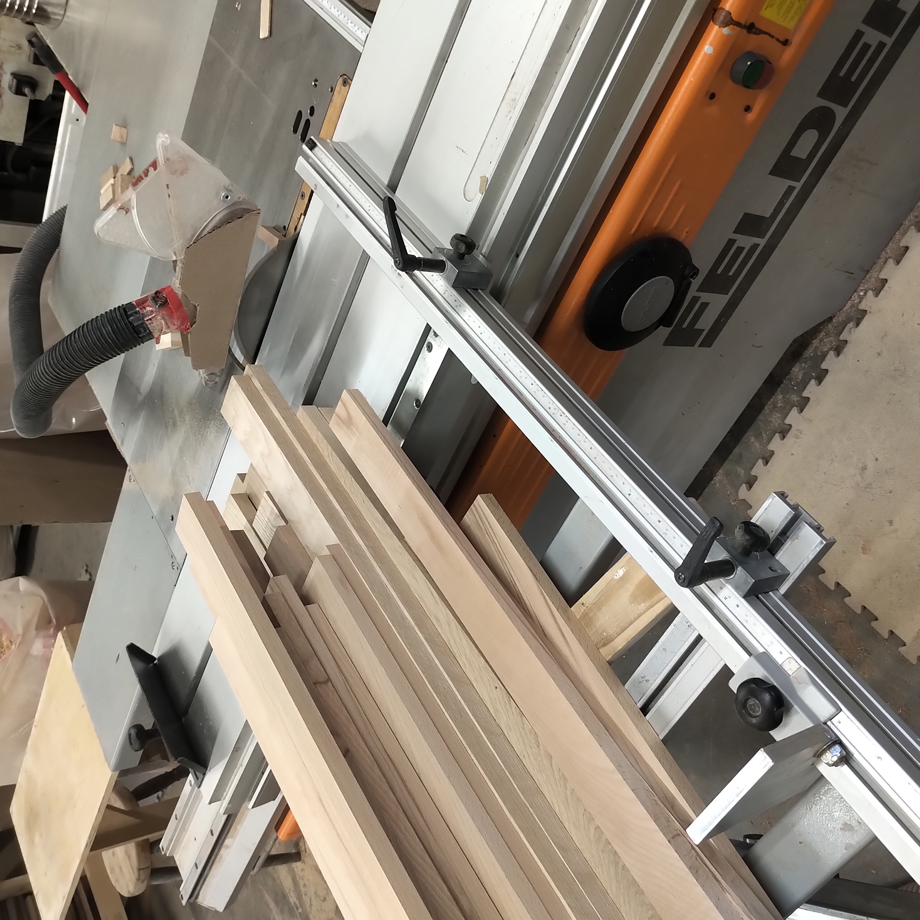

Thomas, here's a couple of glam shots of the s4s for ya.
Sexy beast! Can't show too much cause that's on my Only Fans channel.
