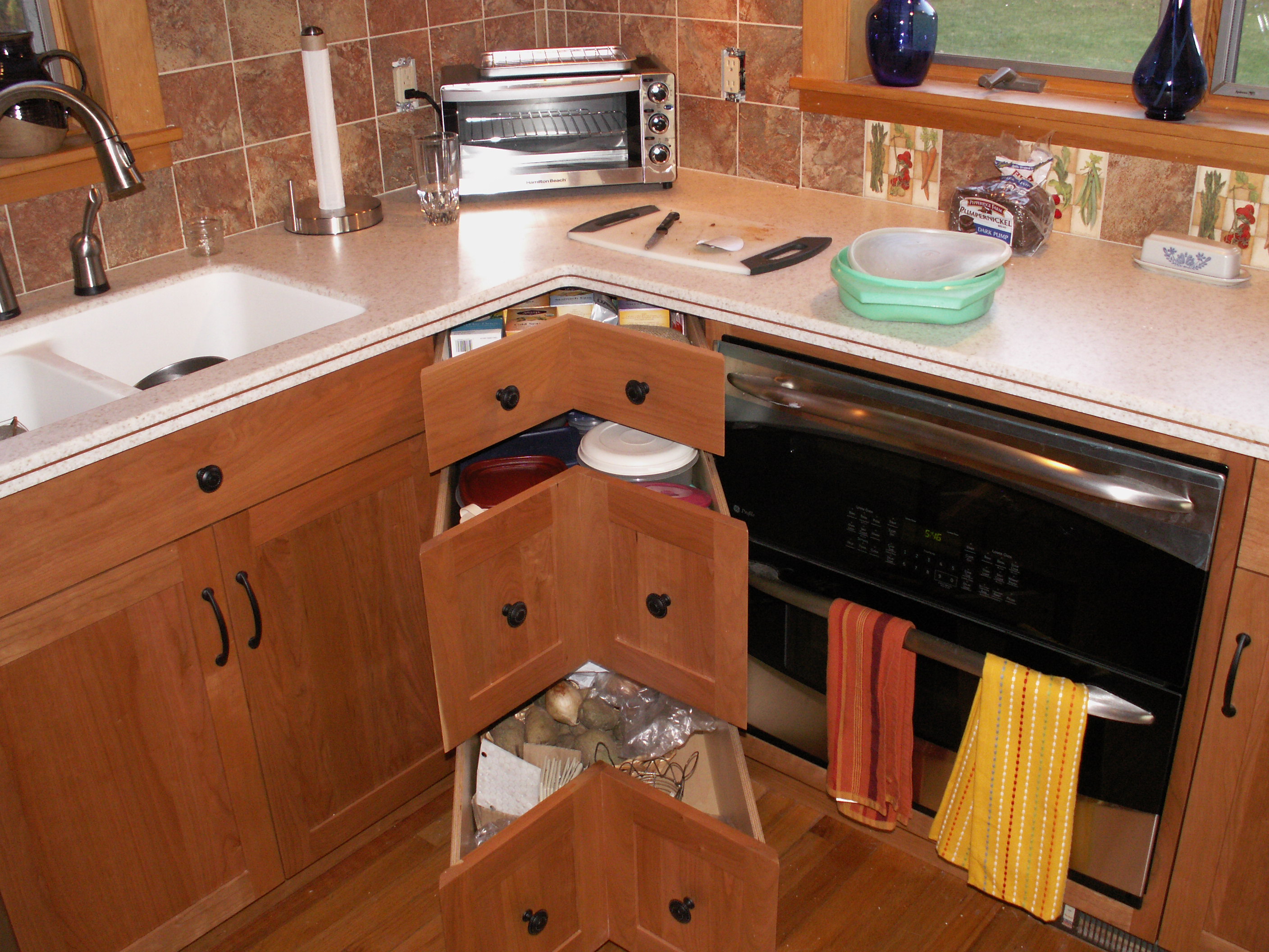

Ideally you'd want to use a 24' slide to maximize the space. Attached is a photo of one I built with 21" guides.
I lay out the pieces to scale on a cutout of plywood in the plan view and build to that. The sides of the drawer are much longer than the guide, you will want to have a locking device for the drawer slide on hand to lay in there for calculating where to add additional blocking to fasten it, this mimicks the "front" of the drawer box. I wish I had more photos to share, basically build a cabinet with the 90 degree front corner and add that feature to a standard drawer.

Like Josh, I don't have a portable shop drawing, but a 40" square of plywood with full scale drawing (plan view). I build frameless, so I had to incorporate left and right wings that allow the space for the diagonally moving drawer fronts. You should draw in abutting cabinets to doubly check for clearance. Drawers in attached photo ended up clearing adjacent oven trim by about 1/16".
I use Eagle Woodworking for all my drawer boxes. They build these drawers set up to receive 24" Blumotion slides. I order the boxes as ht. x 15 1/2" x 27".
Don't even think about charging less than $2K for this cabinet.

Also, take extra precaution when an appliance is in the opening next to a corner drawer unit. You may need to account for extra clearances there as well. and install the handles on the fronts prior to attaching them to the drawer box, much easier that way.

Hard to wrap the brain around how the drawer front clears the door next to it and maintain a 1/8" reveal but I guess its possible.
