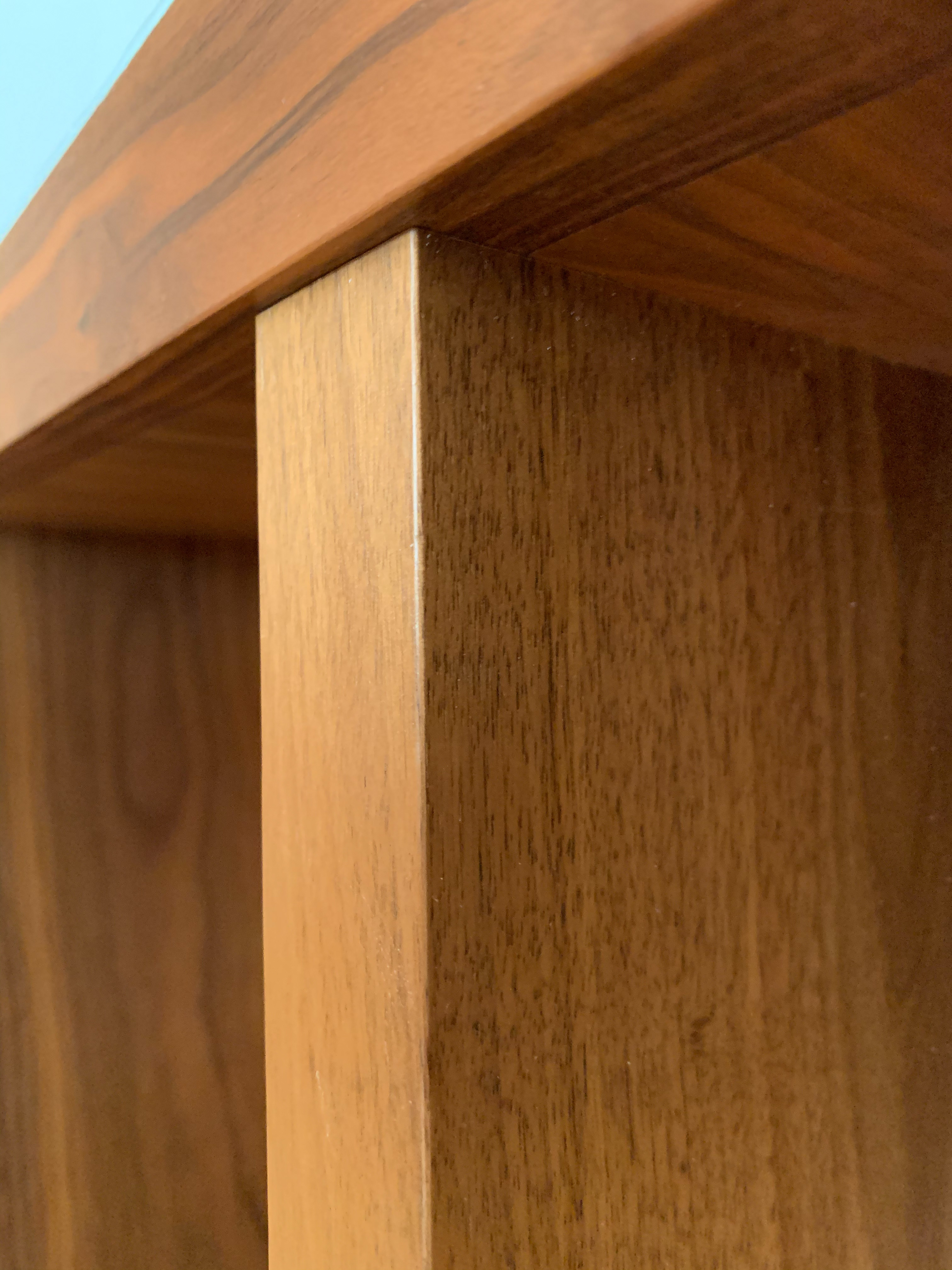

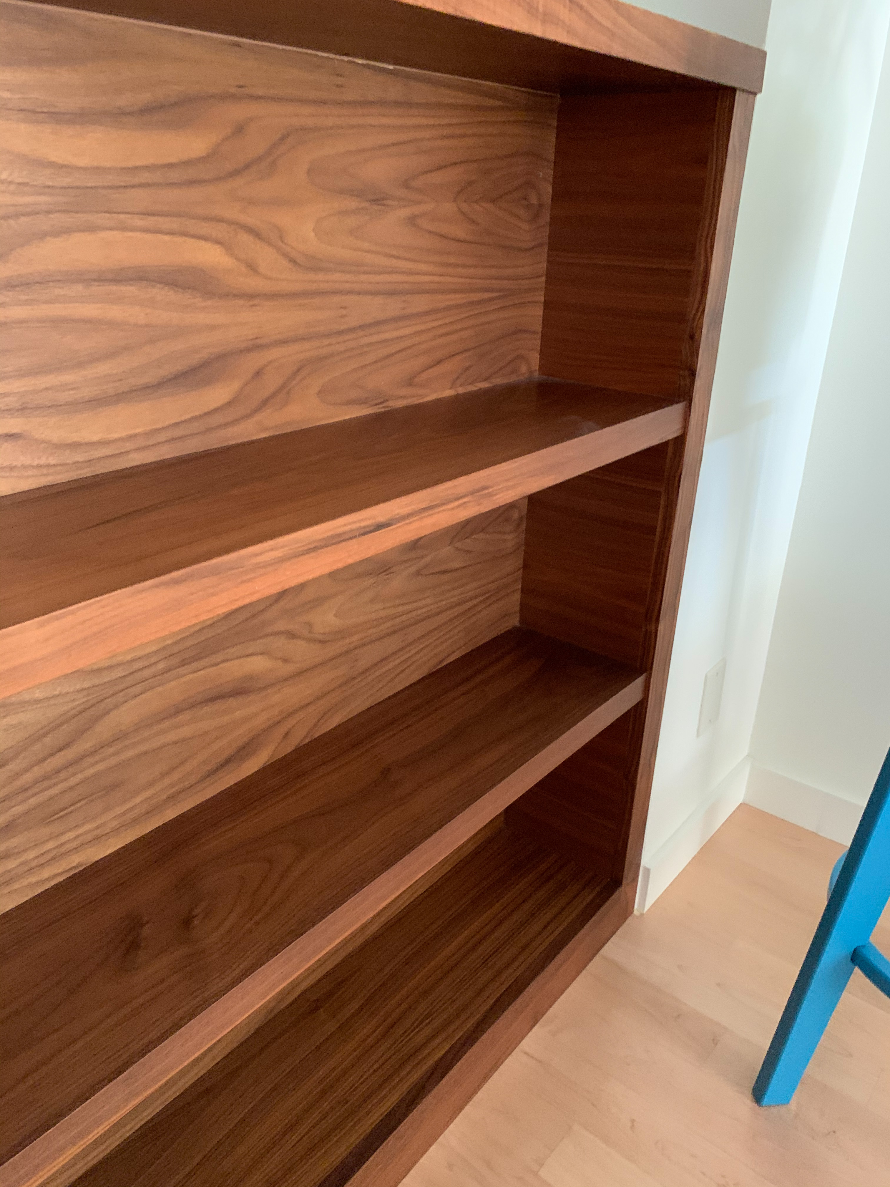

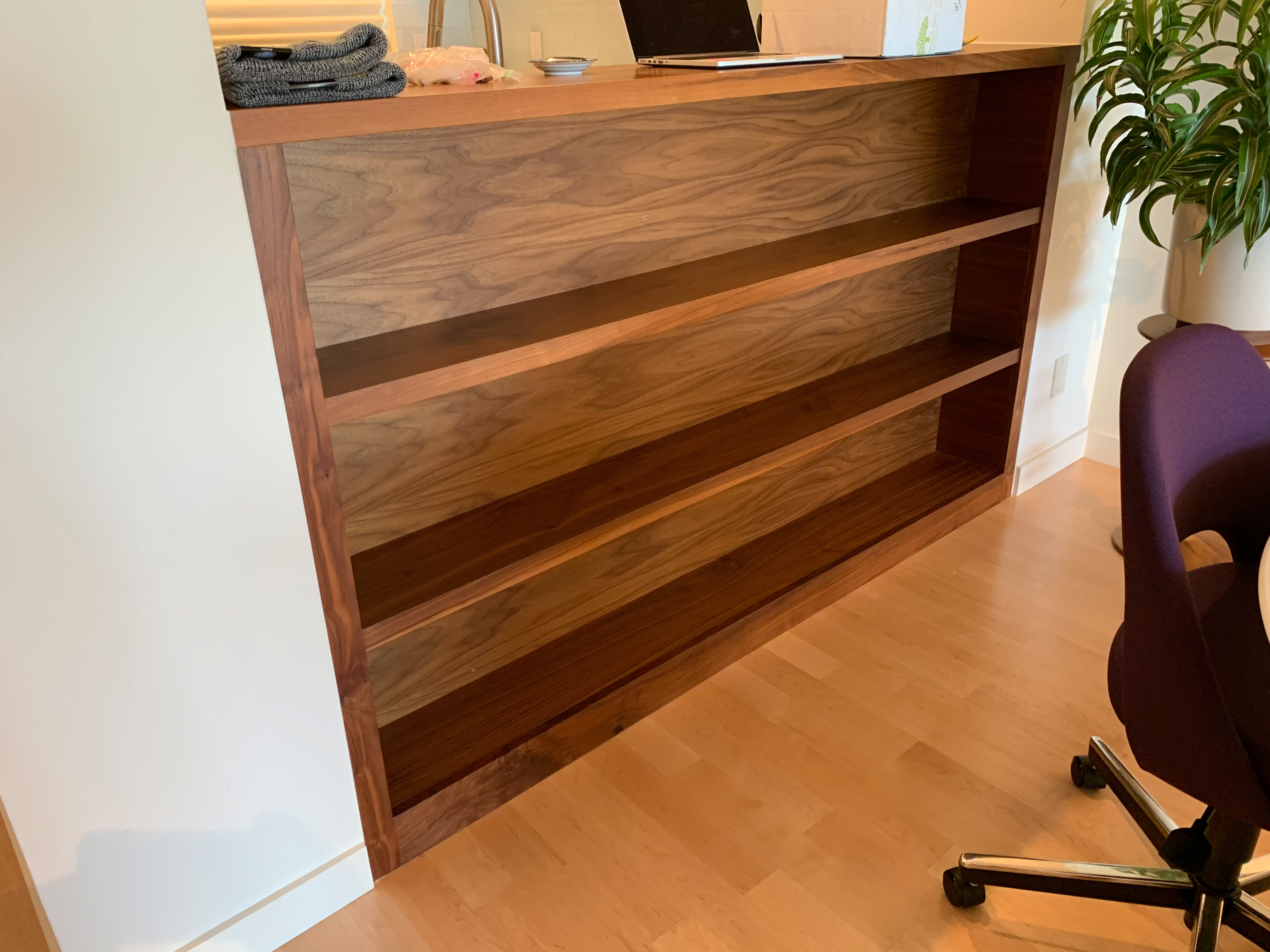

Hello, Im trying to identify the construction techniques in this built in. IE: based on grain direction does it look like the sides and shelves are veneered plywood? Obviously, the back is ply... I would assume the top is solid wood and that the faces are solid. Any help would be appreciated. Thanks

All plywood in my opinion. If the side was solid wood with a front to back wood grain direction, it would blow the top off in a humid summer.
