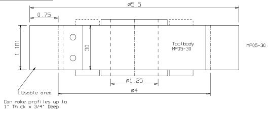

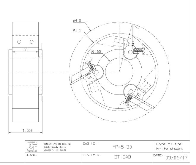

I have two 5hp Powermatic PM2700 shapers. I am going to set them up for cabinet doors. I am going to order a few cutter bodies with backers and inserts. I have pretty much decided to go with Dimensions in Tooling cutters. I am torn between two cutter bodies; the MP05-30 and the MP45-30. The MP-05 has a 4" minor and 5.5" major while the MP45 has 3.5" minor with a 4.5" major diameters (both are 1.25" bore). I am currently running import carbide cutters and want to take the plunge to run insert cutters. I am not in a position right now to get 2 10hp shapers so this is what I will be working with for now. I am looking for advice on the cutter bodies. Should I opt for the bigger bodies or go with the smaller bodies? I plan to keep a straight cutter and a sticking cutter on one machine and cope and door edge profile on the other (2 cutter bodies at a time on each machine). My gut is telling me to go with the larger bodies so when I do get my 10hp machines I'm set, but I am concerned about the weight on the current setup if I go with the larger cutters. What do you guys think? Am I overthinking this? I have attached the CAD files DIT sent me.
View higher quality, full size image (541 X 224)
View higher quality, full size image (660 X 557)

Based on cutter weight and the machine you are going to run I'd go with the smaller cutters. Stacking cutters will make the weight issue a bigger deal. I have on Powermatic machine with stacked cutters (Freeborn brazed tooling) I have no spindle height change or fence movement to go from cope cut to stick cut. I do have to move the power feeder out of the way for coping. I only use this machine for glass rebate door parts.
I'd suggest not stacking cutters but rather make the change with shims that work for the height so you don't have to move the spindle. I do this with my other machines. Also, I use an out board fence and gauge blocks to set the fence. Makes changes in set up real simple. I change bits by putting the correct spacers under and tightening them down. The shaper fence is set for a cut that doesn't use the out board fence, it doesn't get changed.

They'll live for a while with the larger heads. I wouldn't stack them though.
Even in a pretty soft job of coping, they'll be tough on bearings.
Lots of potential to have a sloppy fit. I ran the bigger heads in a couple of 27's for years, but it's less than ideal.
