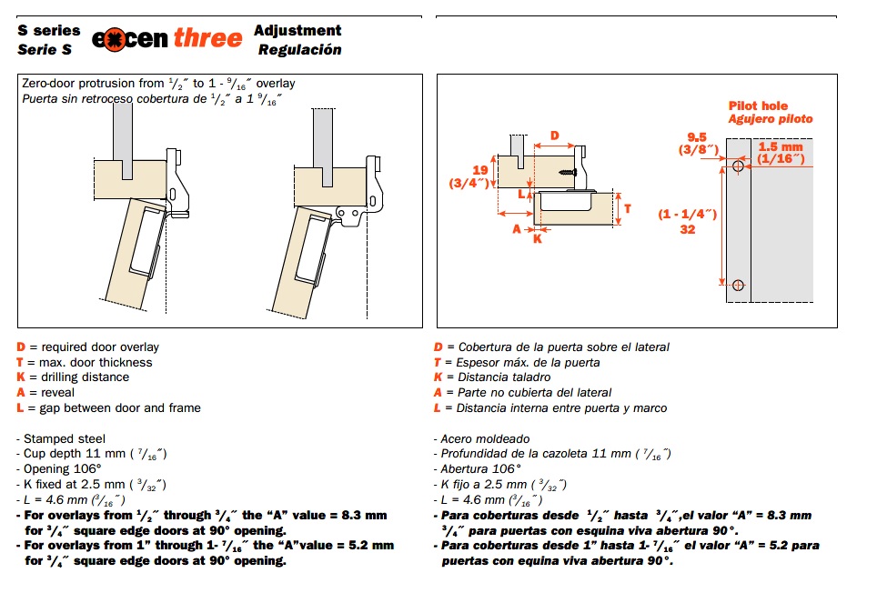

The Salice, S Series Excenthree, compact face frame hinge requires 3/16" clearance with 3/4" thick doors. For your 13/16" doors you will likely need 1/4" clearance. The Blum hinge is more like the one you have already tried.
CSR3A99NR 1-1/4" with dowels, self close, 3 Cam adjust
CUR3AD9R 1-1/4" with dowels,, SOFT CLOSE, 3 CAM adjust
Here is the technical info.
Best of luck
Dennis
