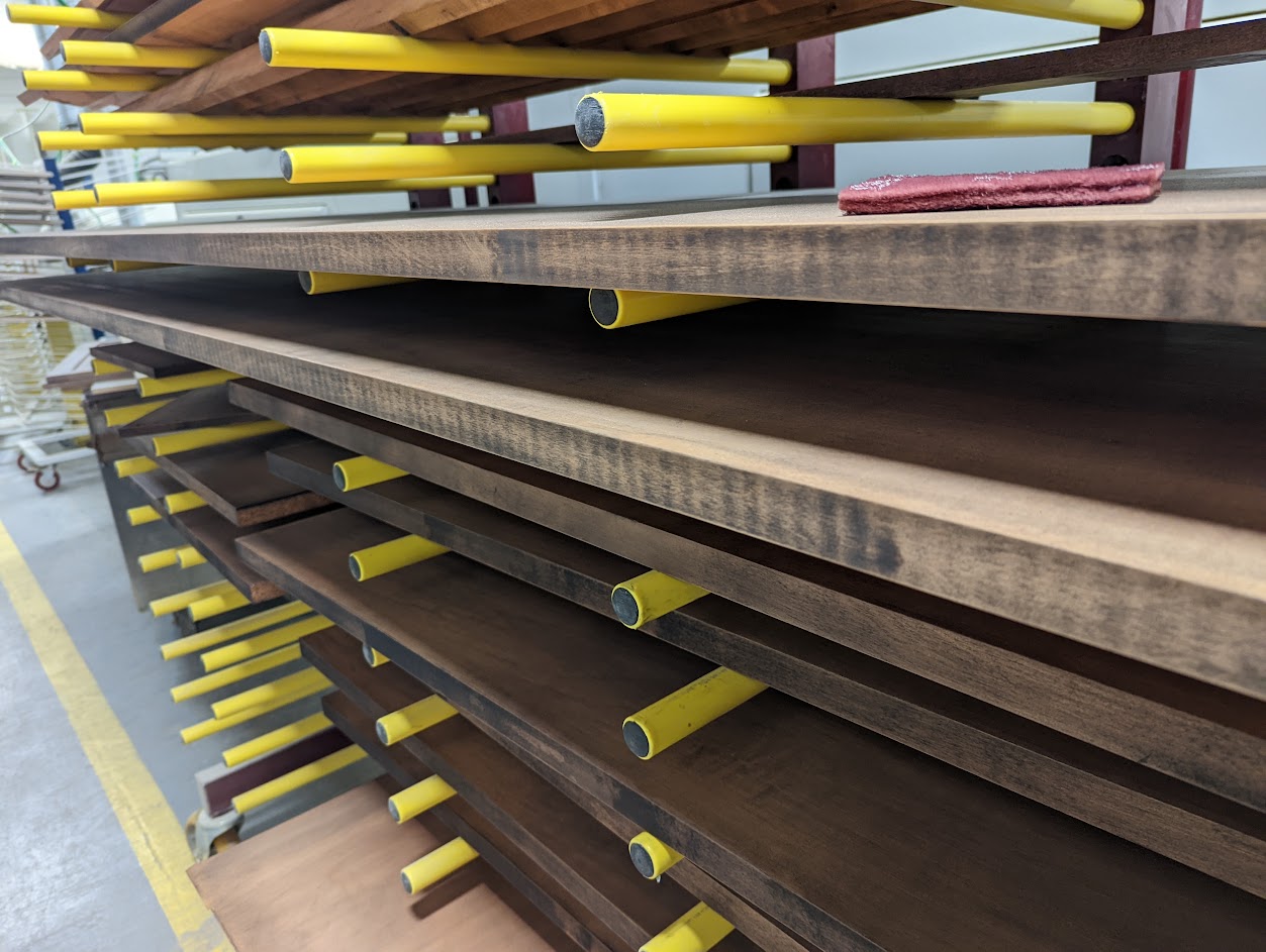

I'm getting a ripple pattern on my parts and I'm having trouble figuring out why.
The long edges have a ripple pattern while the short edges do not.
There has been a black glaze applied that really shows the ripples as you can see.
I tried the edge tape on other parts and couldn't reproduce the issue.
My best guess from research is "milling waves".
Would this be because of the thickness of the part?
Any advise would be appreciated!

Looks like a feed or pressure roller issue. How old are the rollers?

Whats the substrate? Have you been able to figure out if its telegraphing from the substrate or in the banding? Premill? No premill?
Looks clearly to be some sort of harmonic somewhere in the process either in milling the substrate and telegraphing through the banding or in the banding itself. You say it doesnt happen on short parts which narrows it down a bit.

@ RichC the rollers are good, thats what I had thought initially but the wavelength between the ripples is too narrow (in my opinion) to be one of the rollers.
@Mark B - it's particle core, we used the edge tape on other parts and couldn't reproduce the effect, so I figure that would eliminate the tape itself being the issue, it does get pre-milled.
It is a thicker substrate 1.25" vs the regular 62" thick substrate.
I'm kind of wondering if the milling feeds and speeds would need to be adjusted for thicker material but also, on the same material, the narrow ends didn't have this effect.
This really is a mystery to me!

Are you saying on the same part with a long edge and a short edge you only get the mill marks on the long edge with the same banding and operations?
To me the ripple is so precise it definitely speaks to a harmonic balance issue somewhere in the system and it would seem to most definitely be in the premill. We have a shaper in the shop that has a fussy spindle and when we edge material on that shaper and the spindle hasnt been clocked with an indicator, and using a helical insert head, we get the exact same result though its not banded. But all that is moot if your pre-milling other parts and they come out fine with the same banding.
That perfectly repeating pattern to me speaks to something harmonic in the process. Id be hard at the premill for either some out of balance, poorly set inserts, etc.. That pattern is so perfectly timed you know its some sort of a balance issue somewhere.

Run a test part without pre-mill and glaze it and see what happens. That would lock the pre-mill in/out immediately.

When I zoom in on the picture, there is definitely different intensities to the black. A couple of places the intensity change is still very short. I think the thickness is causing some king of feed change yet. If it was the core and premillennialism, why would you get an intense black for 2" and then almost fade out towards the end of the board?

Incorrect thickness adjustments on the pressure beam allowing the premill cutter to drift in an out with a set frequency. Just a guess.

I've seen this on pre-glued iron on edge banding. It comes that way from the factory and even a good sanding doesn't always get rid of it.
Test some raw edge banding that hasn't gone through the machine and see if the pattern is there.

@MarkB Yes, same part, same tape, same machine. Long edge got the ripple, short edge did not.
I will run some test parts soon and see what that looks like.
@RichC the part got glazed with a black glaze, that's where the black is coming from, they probably just wiped more of the glaze off of the ends.

Stange same banding same parts same everything and long edges have the marks and the short edges dont. Are all the parts cnc cut?

Yes all CNC cut, so there are many variables at play on this one.
I have yet to reproduce the problem, I will keep you guys posted though.

Put some glaze on the un applied banding.
