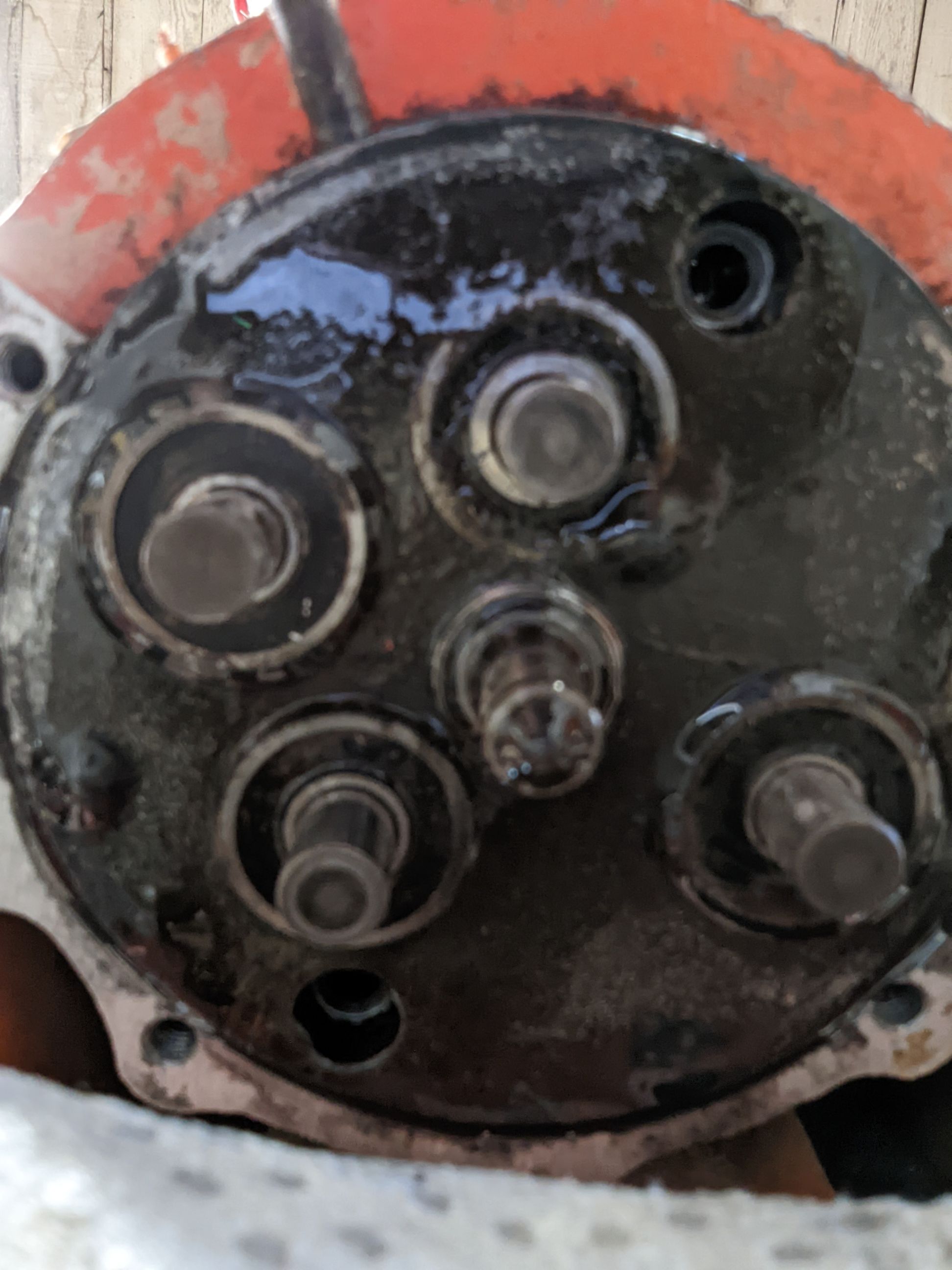

I have a 1985 Blum minipress in which the gear box has failed.

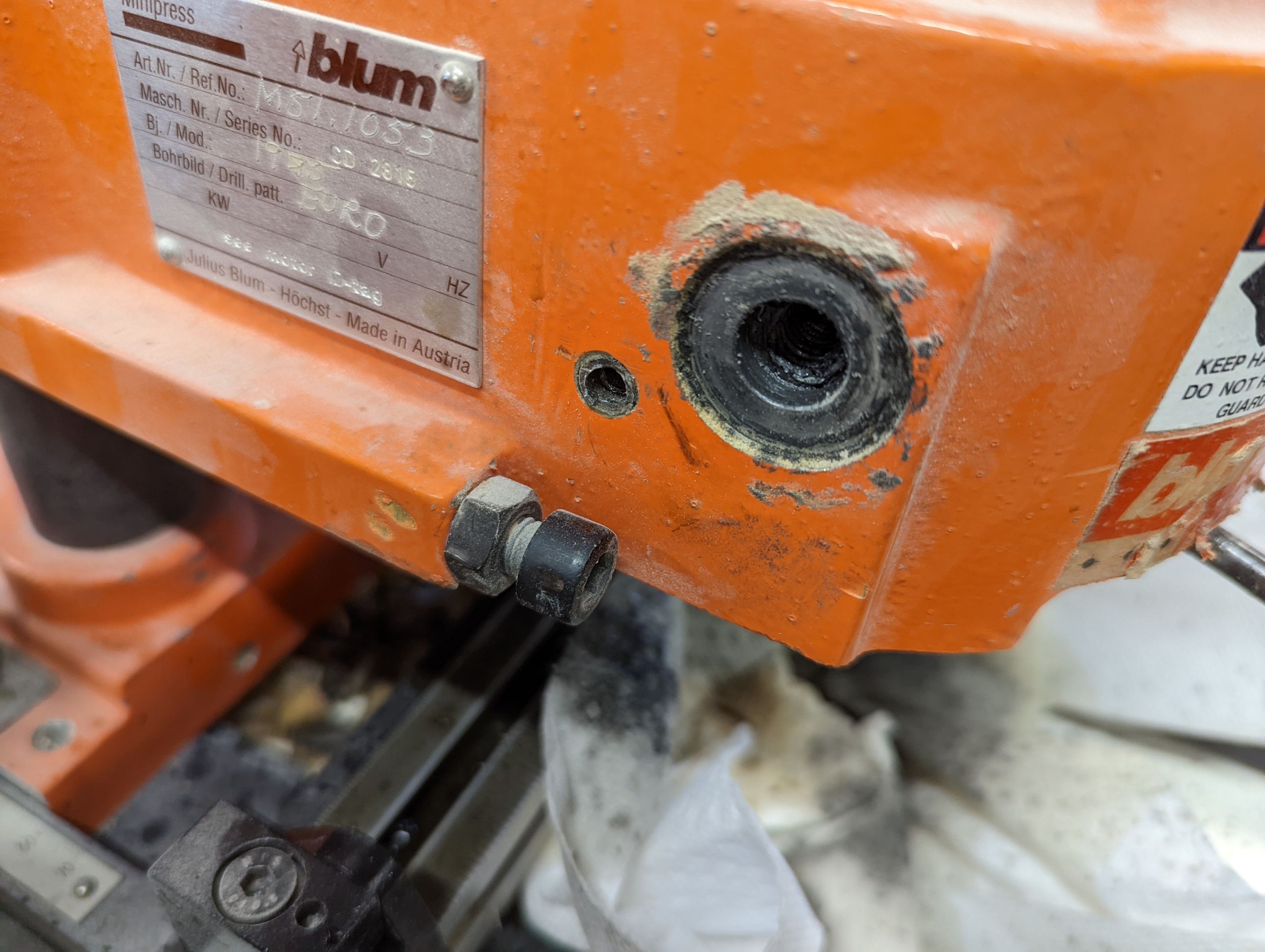

I have the minipress taken apart, but I cannot get the gear box to drop out. I have removed every screw I can find, but there are two recesses or set screws just behind where the hinge press arm attaches (see pic). If they are set screws, they may be stripped out because I cannot get any allen wrench to fit. Can you tell me if these are in fact set screws, and if they are holding the gear box in?
The gear box will move down only about an 1/8 inch and then it won't budge. I have the motor off so I've even tried driving it down with a hammer and it won't move.
Also, it seems very tight in the housing. I'm not able to rotate it without putting a wrench on the small lever. I've soaked it with liquid wrench thinking it may be rusted, but no help.
Does anyone have any experience with this?

Are you sure they are not double set screwed? Its not uncommon to have a set screw in a hole and then install a second set screw over top to lock in the first and make sure it doesnt back loose.

Thanks for the replies. I got a response from Blum and was able to get it out. Kind of unbelievable but I had to drill a hole in the housing and press in a retaining ring, and it worked!
