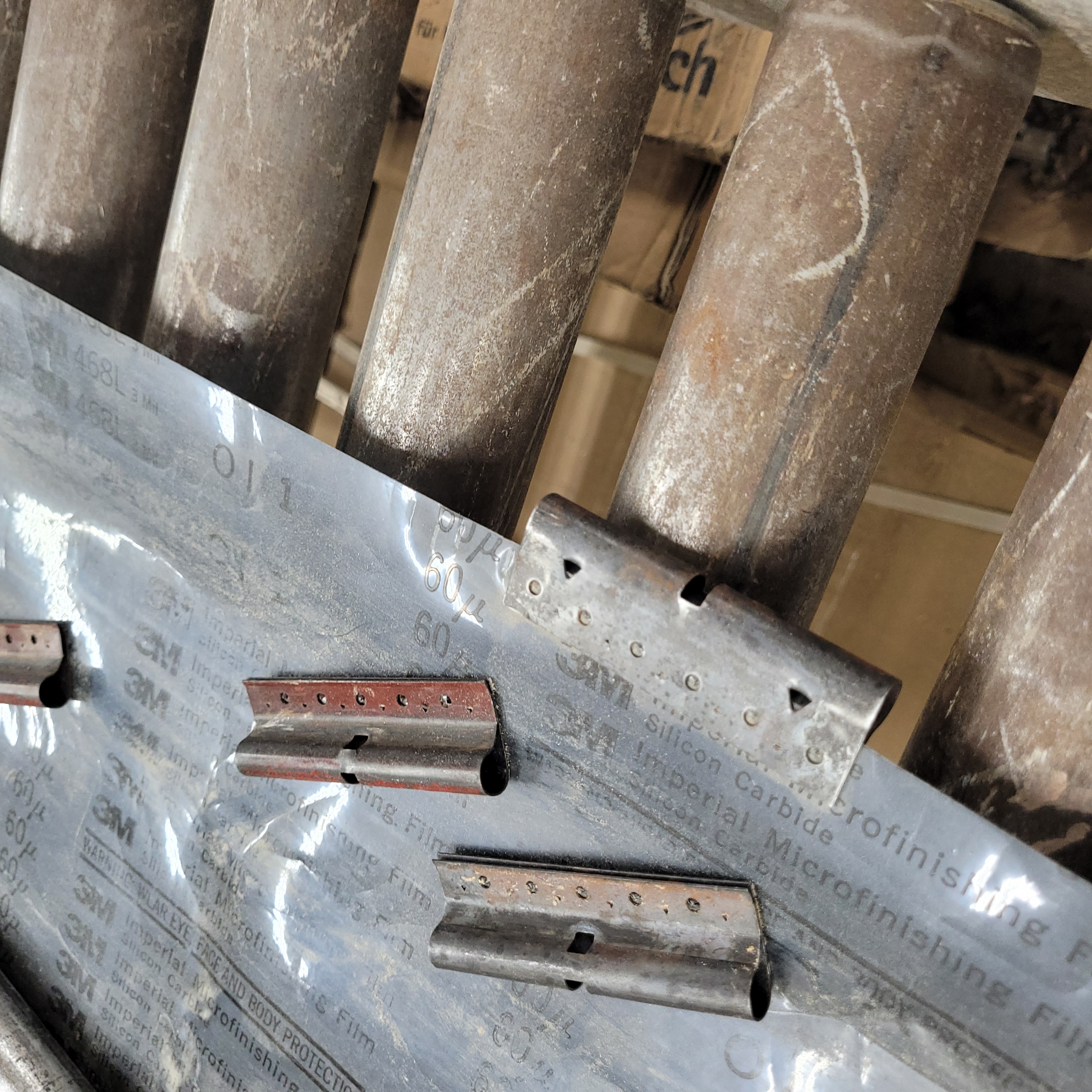

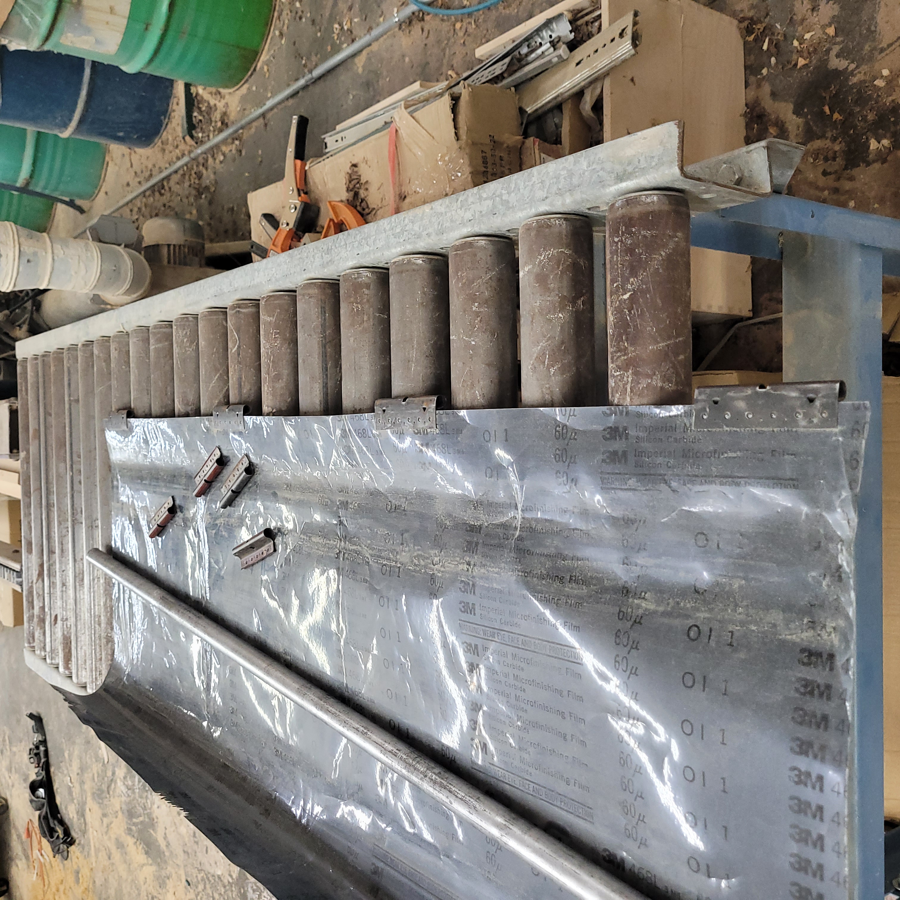

I recently purchased a wide format dual oscillating pad sander with denibbing brush on the second head
Does anyone know of a source for the edge clips and pliers necessary to spread the spring steel clips to install on the paper?
8/31/22       #2: Sandpaper edge clips ...
Mark B Member
No idea but wonder if a set of snap ring pliers may work.
8/31/22       #3: Sandpaper edge clips ...
Jim
Lightly modified external snap ring pliers are the ticket
