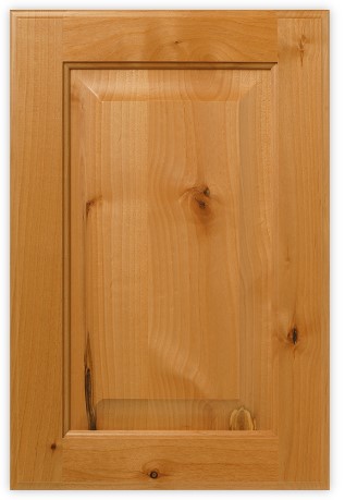

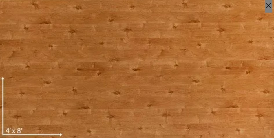

For a frameless job for which the exposed face of everything is from Walzcraft, the species rustic alder, finish no stain natural, we have only two cabinet sides visible. Everything else is wood doors, drawerfronts, trim, fillers, prefinished alder edgetape, applied panel ends. See the images attached, one is the Walzcraft door, the other is snipped from Roseburg's web page and shows their TFL Duramine melamine laminate in rustic alder.
We can get knotty alder veneer plywood for cutting at the CNC, but then we have to finish it. If we can reasonably source melamine with the rustic alder Duramine, it can work if the Duramine texture compares well to the finished wood.

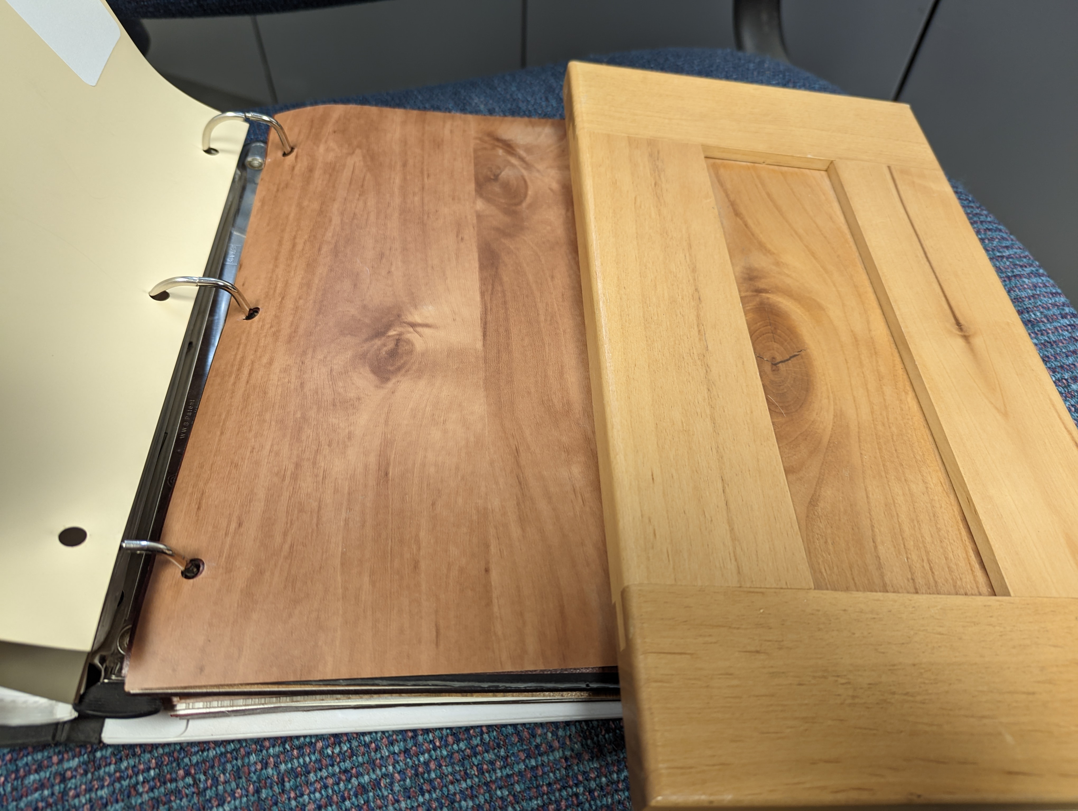

I don't think its close enough. It has more of a reddish tone.
