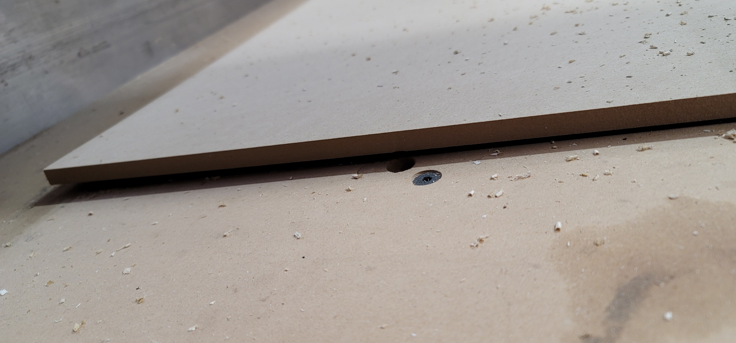

Slight weather change and here is my spoil board... 1 day. Add in the skins and its a free for all. We do a good bit of MDF carved panels, full sheets, keeping the stuff flat is only possible by cutting a grid relief on the back side.
