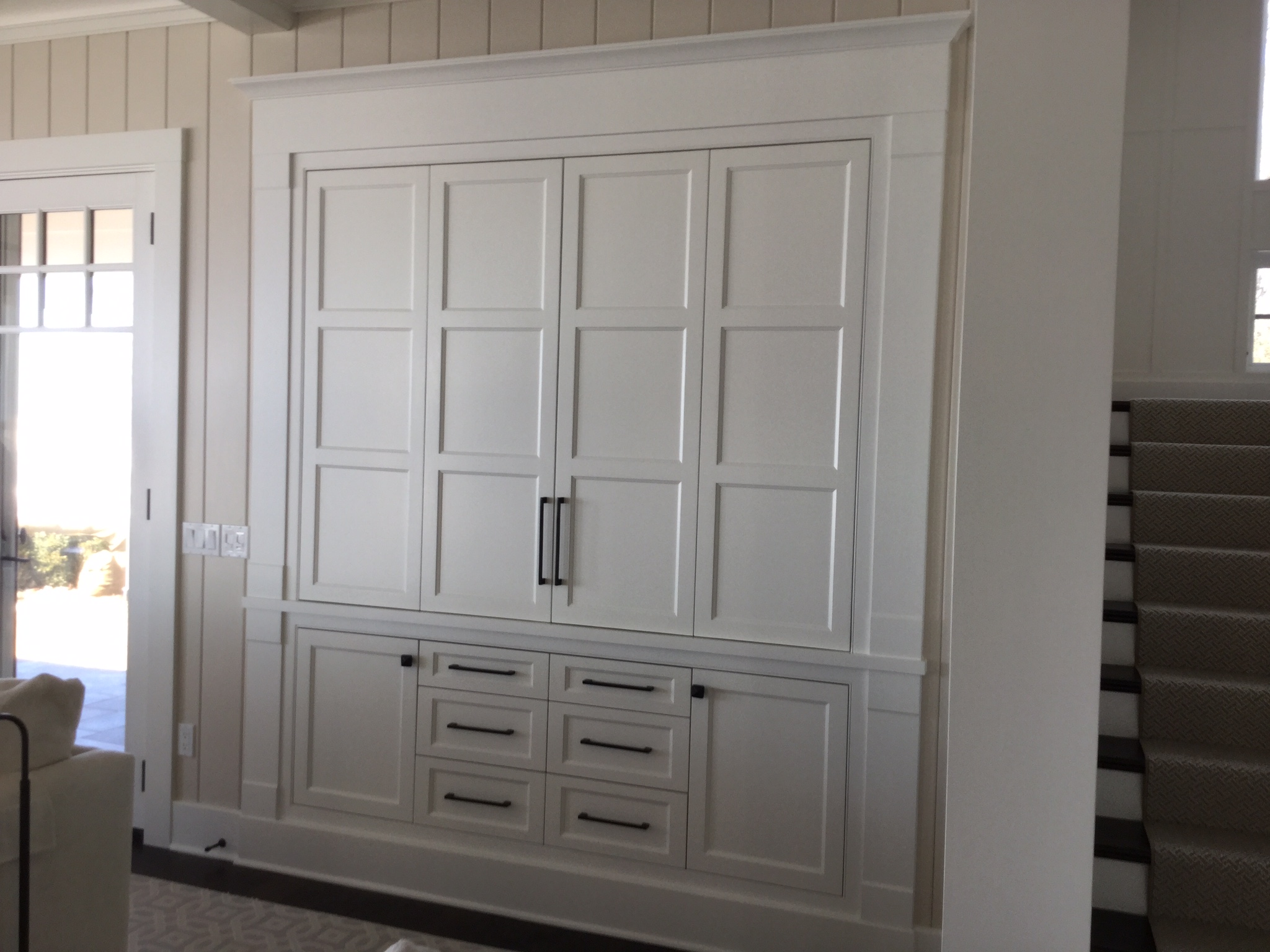

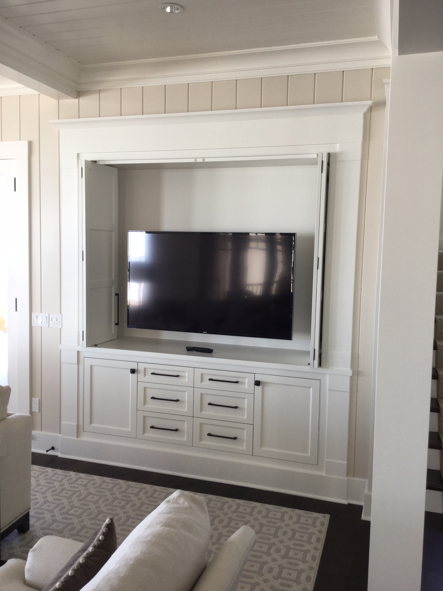

We are looking for help in finding a pocket door hardware that will allow for hiding 2 sets of bifold doors that hide the TV in the attached drawing. We are looking at Hafele Hawa Concepta 25. However, the pocket needed with this hardware is too large, which makes the available space for the TV too small.
Thanks for any advise

I used KV 8092 pocket door slides for this TV cabinet. If your doors are 3/4" thick, you will need about a 3" space to retract your bifolding doors.

These do work great, but how did you create a bifold condition and have 2 doors per side retract?
12/13/22       #4: Pocket door hardware ...
Brian
12/14/22       #5: Pocket door hardware ...
Karl E Brogger  Member
One door doors flat(ish) against the other, then push them into the hole.
I used to use piano hinges, I'm sure there's better options
12/14/22       #6: Pocket door hardware ...
duster
I get the bifolding hinges from my hardware supplier (Wurth Louis) when I order the KV 8092 slides. I'm not sure who makes them, but they snap open and closed and have a screw for adjustment. They mount flat onto the back of the doors, no mortising needed.
